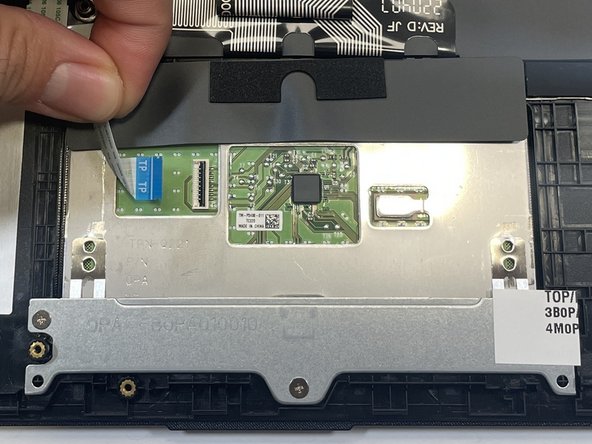

  5. HP 14-dq0060nr Touchpad Replacement, Touchpad: crwdns2935265:05crwdnd2935265:01crwdnd2935265:02crwdne2935265:0 HP 14-dq0060nr Touchpad Replacement, Touchpad: crwdns2935265:05crwdnd2935265:02crwdnd2935265:02crwdne2935265:0
    • Use the tip of a spudger to lift the bar holding the touchpad cable in place, then disconnect the touchpad cable.

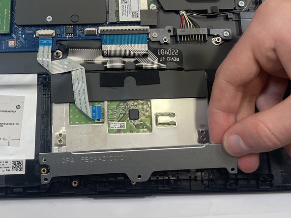

  6. HP 14-dq0060nr Touchpad Replacement: crwdns2935265:06crwdnd2935265:01crwdnd2935265:02crwdne2935265:0 HP 14-dq0060nr Touchpad Replacement: crwdns2935265:06crwdnd2935265:02crwdnd2935265:02crwdne2935265:0
    • Use a Phillips #1 screwdriver to remove the three 2mm screws holding the touchpad bracket in place.
    • Remove the touchpad bracket.
