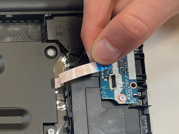

  5. HP 14-dq0060nr Card Reader Board Replacement, Card Reader Board: crwdns2935265:05crwdnd2935265:01crwdnd2935265:02crwdne2935265:0 HP 14-dq0060nr Card Reader Board Replacement, Card Reader Board: crwdns2935265:05crwdnd2935265:02crwdnd2935265:02crwdne2935265:0
    • To disconnect the cable from the card reader board, use the tip of a spudger or your fingernail to flip up the small locking flap of the ZIF connector. Then, you can safely pull the cable out.
    • Be sure to pry up on the hinged flap, not the connector socket.
  6. HP 14-dq0060nr Card Reader Board Replacement: crwdns2935265:06crwdnd2935265:01crwdnd2935265:01crwdne2935265:0
    • Use a Phillips #1 screwdriver to remove the two 3.0 mm screws securing the card reader board to the chassis.
  7. HP 14-dq0060nr Card Reader Board Replacement: crwdns2935265:07crwdnd2935265:01crwdnd2935265:01crwdne2935265:0
    • Use tweezers to carefully remove the card reader board.
