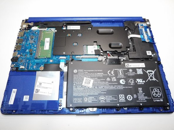

    • After the bottom panel has been separated from the laptop, close the laptop.
    • Flip the laptop back over.
    • Carefully place hands on either side of the laptop's back panel.
    • Lift up to remove the panel.
  4. HP 14-dq0055dx Speaker Replacement: crwdns2935265:04crwdnd2935265:01crwdnd2935265:02crwdne2935265:0 HP 14-dq0055dx Speaker Replacement: crwdns2935265:04crwdnd2935265:02crwdnd2935265:02crwdne2935265:0

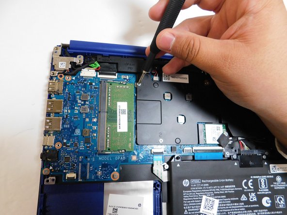

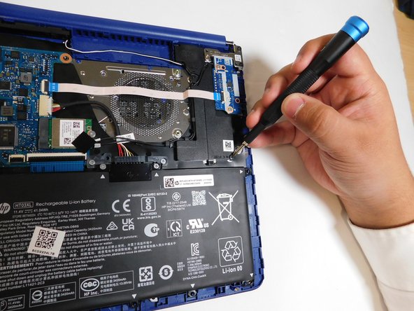

    • Remove the five 2.5 mm screws holding the heat sink plate.
  5. HP 14-dq0055dx Speaker Replacement: crwdns2935265:05crwdnd2935265:01crwdnd2935265:03crwdne2935265:0 HP 14-dq0055dx Speaker Replacement: crwdns2935265:05crwdnd2935265:02crwdnd2935265:03crwdne2935265:0 HP 14-dq0055dx Speaker Replacement: crwdns2935265:05crwdnd2935265:03crwdnd2935265:03crwdne2935265:0

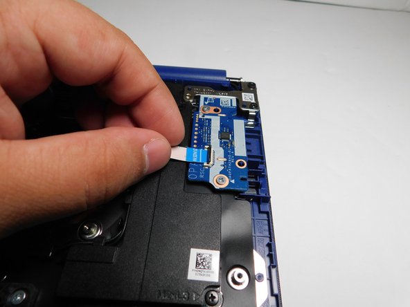

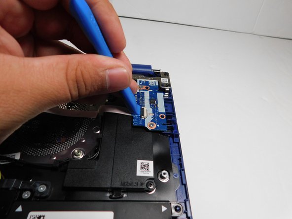

    • Remove the ZIF cable by pulling the black clasp up.

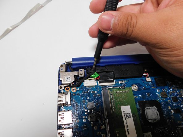

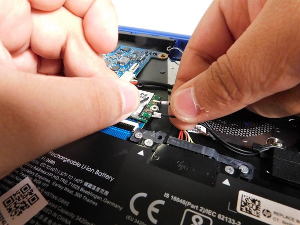

    • Lift the black adhesive square card covering two small cables connected to the WIFI card.
    • Unplug the small wires one and two with your fingers.
    • Unravel the cable from the right speaker.

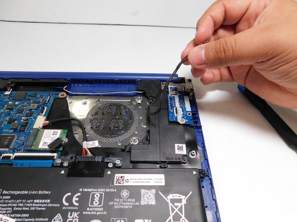

    • Remove the three 2.5 mm screws located on the speakers.
  8. HP 14-dq0055dx Speaker Replacement: crwdns2935265:08crwdnd2935265:01crwdnd2935265:02crwdne2935265:0 HP 14-dq0055dx Speaker Replacement: crwdns2935265:08crwdnd2935265:02crwdnd2935265:02crwdne2935265:0

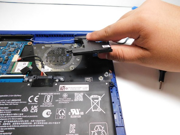

    • Lift the top speaker gently so the wires are taught.
    • Pull slightly to disconnect.
