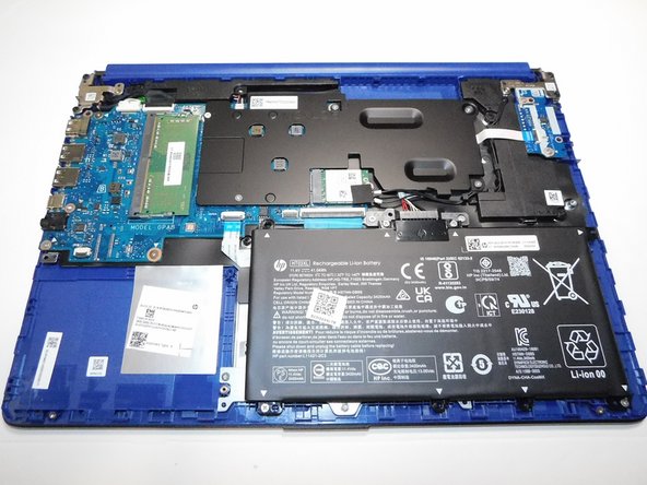

    • Turn the laptop upside down exposing the screws.
    • Gently remove the rubber grips to reveal the remaining screws.
    • Using a Phillips #1 screwdriver remove all eight screws.

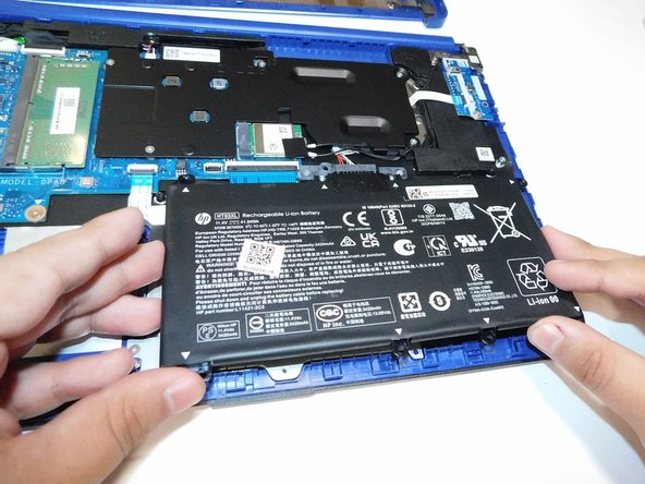

    • After the bottom panel has been separated from the laptop, close the laptop.
    • Flip the laptop back over.
    • Carefully place hands on either side of the laptop's back panel.
    • Lift up to remove the panel.

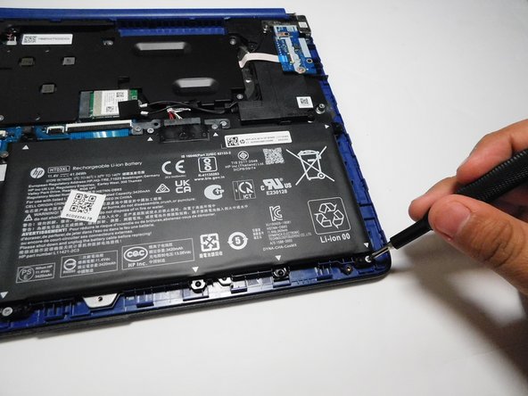

    • Using a Phillips #1 screwdriver remove the four 2.5 mm screws securing the battery in place.
    • Remove the battery from the laptop by gently lifting up the bottom slightly.
    • Pull the battery toward you to remove.
    • Be wary of not bending the pins when pulling the battery out.

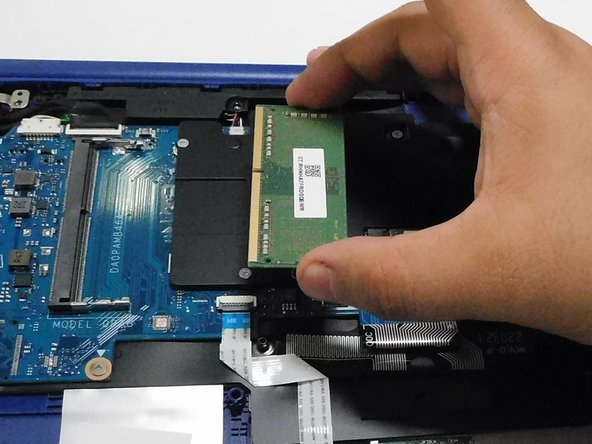

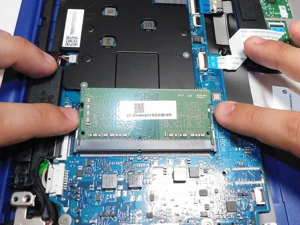

    • Release the metal clasps on the sides of the RAM module by gently pulling away.
    • The RAM will spring upward and remain at an angle.
    • Pull the module out at the same angle.
    • Do not touch the gold pins on the RAM module.
