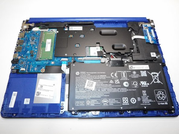

  3. HP 14-dq0055dx Charging port Replacement: crwdns2935265:03crwdnd2935265:01crwdnd2935265:02crwdne2935265:0 HP 14-dq0055dx Charging port Replacement: crwdns2935265:03crwdnd2935265:02crwdnd2935265:02crwdne2935265:0
    • After the bottom panel has been separated from the laptop, close the laptop.
    • Flip the laptop back over.
    • Carefully place hands on either side of the laptop's back panel.
    • Lift up to remove the panel.

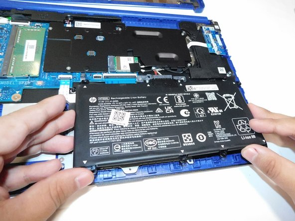

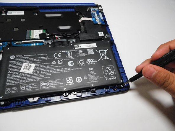

  4. HP 14-dq0055dx Charging port Replacement: crwdns2935265:04crwdnd2935265:01crwdnd2935265:03crwdne2935265:0 HP 14-dq0055dx Charging port Replacement: crwdns2935265:04crwdnd2935265:02crwdnd2935265:03crwdne2935265:0 HP 14-dq0055dx Charging port Replacement: crwdns2935265:04crwdnd2935265:03crwdnd2935265:03crwdne2935265:0
    • Using a Phillips #1 screwdriver remove the four 2.5 mm screws securing the battery in place.
    • To remove the battery, lift the battery slightly toward the bottom.
    • Pull the battery toward you.
    • Do not pull the battery straight up after the removal of the screws.

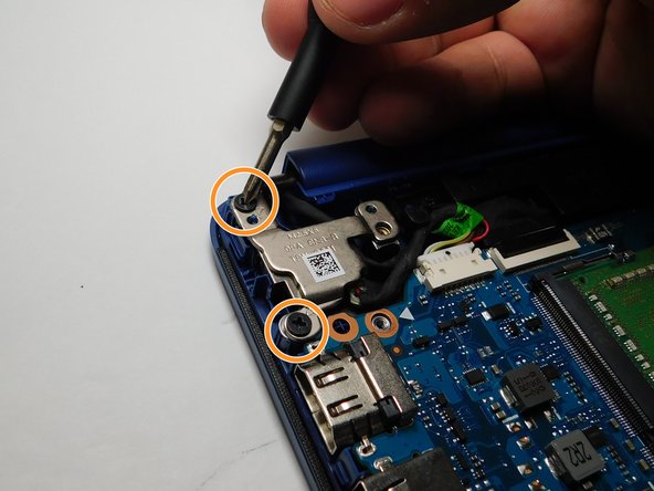

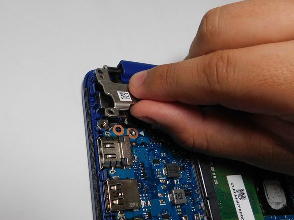

  5. HP 14-dq0055dx Charging port Replacement: crwdns2935265:05crwdnd2935265:01crwdnd2935265:03crwdne2935265:0 HP 14-dq0055dx Charging port Replacement: crwdns2935265:05crwdnd2935265:02crwdnd2935265:03crwdne2935265:0 HP 14-dq0055dx Charging port Replacement: crwdns2935265:05crwdnd2935265:03crwdnd2935265:03crwdne2935265:0
    • Locate the charging port bracket at the top left of the laptop.
    • Remove the two 2.5 mm screws that secure the charging port bracket.
    • Flip the bracket up and away from you.
  6. HP 14-dq0055dx Charging port Replacement: crwdns2935265:06crwdnd2935265:01crwdnd2935265:01crwdne2935265:0
    • Locate the wires connected to the charging port.
    • Carefully pull the white tab out of its socket.
