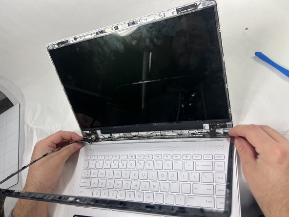

    • Using an opening tool, pry off the bar on the back of the laptop.
    • Standing the laptop up as shown makes it much easier.
  2. HP 14-dq0052dx Screen Replacement: crwdns2935265:02crwdnd2935265:01crwdnd2935265:02crwdne2935265:0 HP 14-dq0052dx Screen Replacement: crwdns2935265:02crwdnd2935265:02crwdnd2935265:02crwdne2935265:0
    • Using an opening tool, carefully pry off the thin black plastic around the edges of the screen.
    • There is some adhesive holding it in place as well as clips.

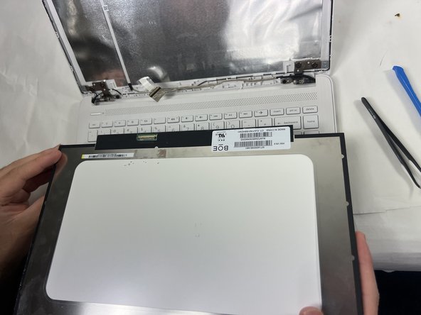

  3. HP 14-dq0052dx Screen Replacement: crwdns2935265:03crwdnd2935265:01crwdnd2935265:01crwdne2935265:0
    • Pull out the double sided tape holding the screen in place.
    • Lay the screen down on the keyboard.

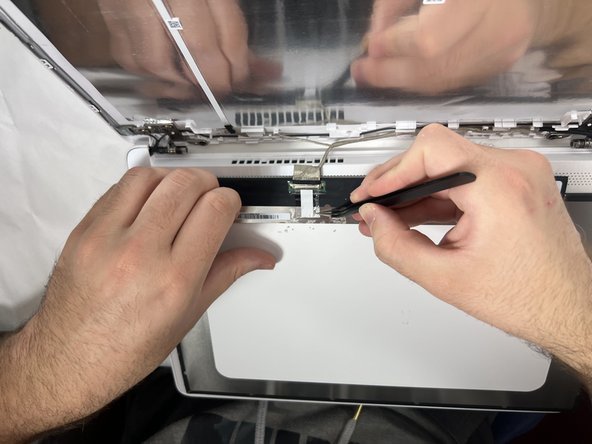

  4. HP 14-dq0052dx Screen Replacement: crwdns2935265:04crwdnd2935265:01crwdnd2935265:03crwdne2935265:0 HP 14-dq0052dx Screen Replacement: crwdns2935265:04crwdnd2935265:02crwdnd2935265:03crwdne2935265:0 HP 14-dq0052dx Screen Replacement: crwdns2935265:04crwdnd2935265:03crwdnd2935265:03crwdne2935265:0
    • Peel off the tape and unplug the screen.
