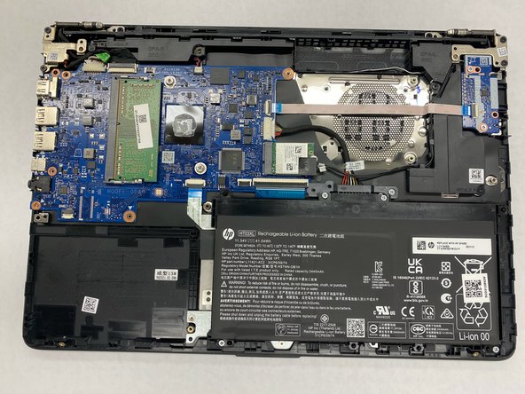

    • Turn the laptop upside down so the backside is facing up.
    • Use a Phillips #1 screwdriver to remove the eight 2.5mm screws from the back case.

    • Once the bottom panel is separated from the laptop, carefully close the laptop and turn it upside down.
    • Place both your hands on opposite ends of the bottom panel, and lift up and remove the panel.
  4. HP 14-dq0051dx Wi-Fi Card Replacement: crwdns2935265:04crwdnd2935265:01crwdnd2935265:03crwdne2935265:0 HP 14-dq0051dx Wi-Fi Card Replacement: crwdns2935265:04crwdnd2935265:02crwdnd2935265:03crwdne2935265:0 HP 14-dq0051dx Wi-Fi Card Replacement: crwdns2935265:04crwdnd2935265:03crwdnd2935265:03crwdne2935265:0

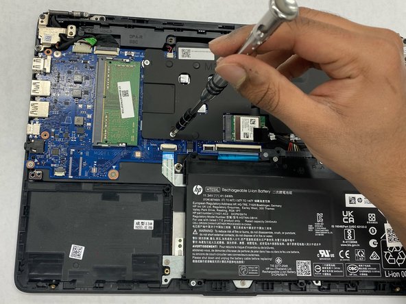

    • Use a Phillips #1 screwdriver to remove the five 2.5 mm screws that secure the motherboard cover.
    • Remove the motherboard cover from the laptop.

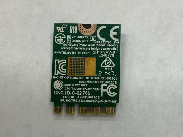

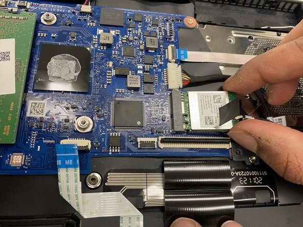

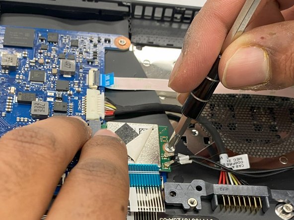

    • Use a Phillips #0 screwdriver to remove the single 1mm screw that secures the WiFi card.
    • Pull the WiFi card out of its slot
    • Pull the WiFi card out slowly and gently as to not damage the card or the slot
  6. HP 14-dq0051dx Wi-Fi Card Replacement: crwdns2935265:06crwdnd2935265:01crwdnd2935265:03crwdne2935265:0 HP 14-dq0051dx Wi-Fi Card Replacement: crwdns2935265:06crwdnd2935265:02crwdnd2935265:03crwdne2935265:0 HP 14-dq0051dx Wi-Fi Card Replacement: crwdns2935265:06crwdnd2935265:03crwdnd2935265:03crwdne2935265:0

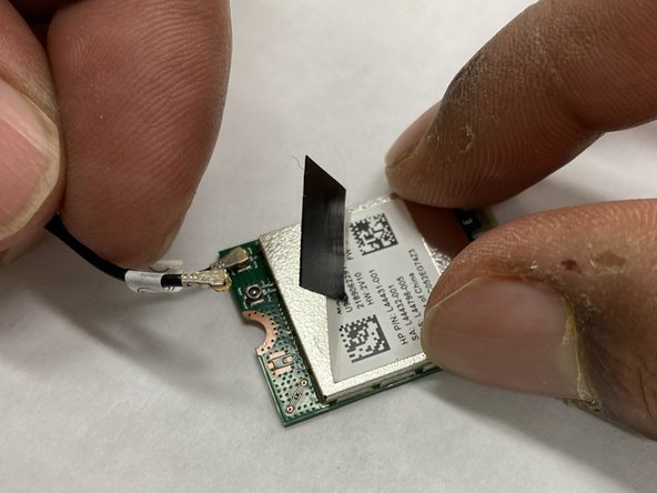

    • Pull the tab up, revealing two small wire plugs underneath
    • Gently remove the wires from their plugs
