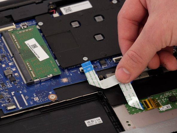

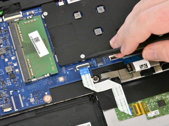

  5. HP 14-dq0051dx Touchpad Replacement, Touchpad: crwdns2935265:05crwdnd2935265:01crwdnd2935265:03crwdne2935265:0 HP 14-dq0051dx Touchpad Replacement, Touchpad: crwdns2935265:05crwdnd2935265:02crwdnd2935265:03crwdne2935265:0 HP 14-dq0051dx Touchpad Replacement, Touchpad: crwdns2935265:05crwdnd2935265:03crwdnd2935265:03crwdne2935265:0
    • Use the tip of a spudger or your fingernail to flip up the small locking flap from ZIF connector that attaches the touchpad cable to the motherboard.
    • Pull the ribbon cable out from the connector.
    • Use caution and do not yank or kink the cable, as you might damage it.

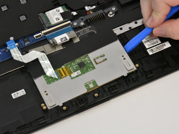

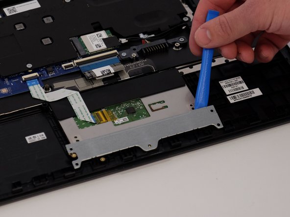

  6. HP 14-dq0051dx Touchpad Replacement: crwdns2935265:06crwdnd2935265:01crwdnd2935265:03crwdne2935265:0 HP 14-dq0051dx Touchpad Replacement: crwdns2935265:06crwdnd2935265:02crwdnd2935265:03crwdne2935265:0 HP 14-dq0051dx Touchpad Replacement: crwdns2935265:06crwdnd2935265:03crwdnd2935265:03crwdne2935265:0
    • Use a Phillips #0 screwdriver to remove the three 2.0 mm screws from the metal plate covering the bottom of the touch pad.
    • Use an opening tool to remove the bottom plate.

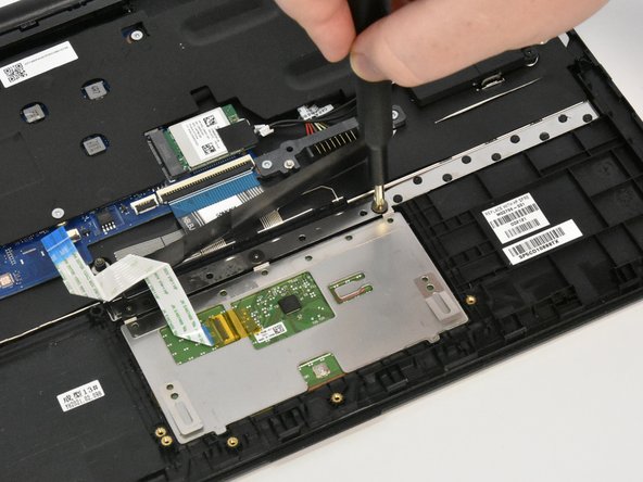

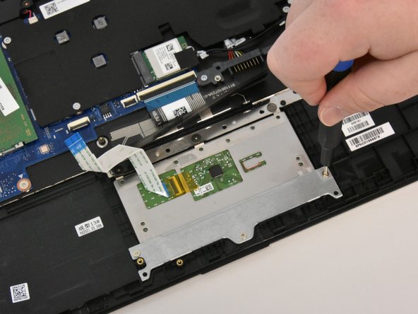

  7. HP 14-dq0051dx Touchpad Replacement: crwdns2935265:07crwdnd2935265:01crwdnd2935265:03crwdne2935265:0 HP 14-dq0051dx Touchpad Replacement: crwdns2935265:07crwdnd2935265:02crwdnd2935265:03crwdne2935265:0 HP 14-dq0051dx Touchpad Replacement: crwdns2935265:07crwdnd2935265:03crwdnd2935265:03crwdne2935265:0
    • Lift up the flap covering to the top of the touchpad.
    • Use a Phillips #1 screwdriver to remove the three 1.5 mm screws from the top of the touchpad.
    • Use the opening tool to carefully lift up and remove the touchpad.
