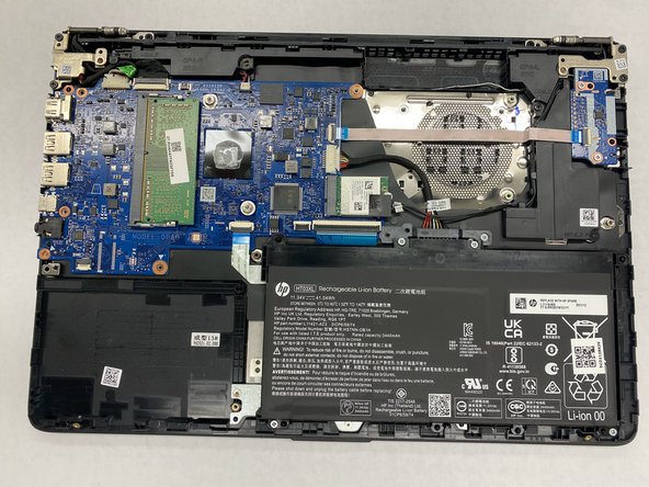

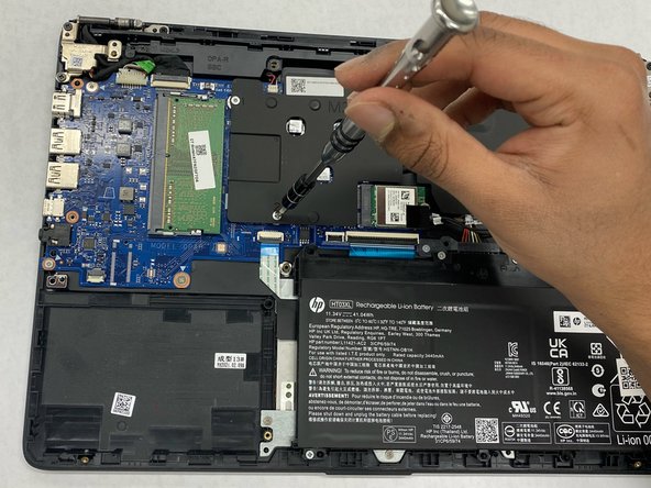

  4. HP 14-dq0051dx Motherboard Replacement: crwdns2935265:04crwdnd2935265:01crwdnd2935265:03crwdne2935265:0 HP 14-dq0051dx Motherboard Replacement: crwdns2935265:04crwdnd2935265:02crwdnd2935265:03crwdne2935265:0 HP 14-dq0051dx Motherboard Replacement: crwdns2935265:04crwdnd2935265:03crwdnd2935265:03crwdne2935265:0
    • Remove the five 2.5 mm screws that secure the motherboard cover using a Phillips #1 screwdriver.
    • Using your hands, remove the motherboard cover from the laptop.

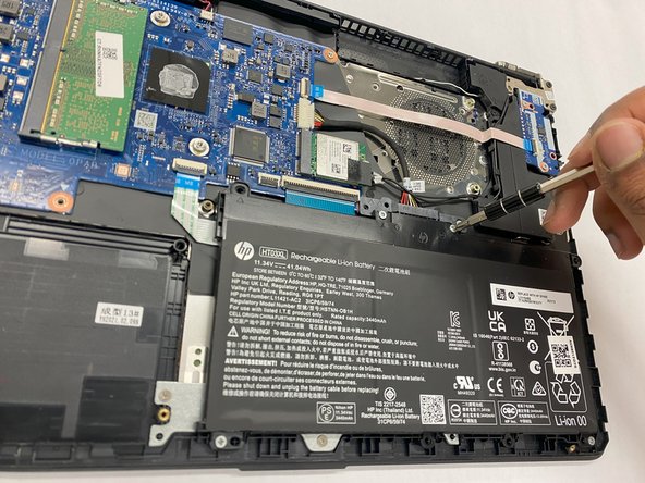

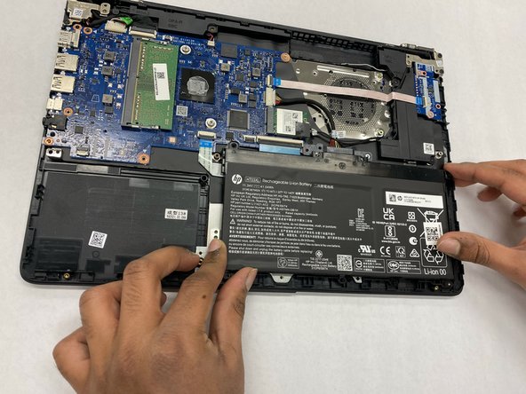

  5. HP 14-dq0051dx Motherboard Replacement: crwdns2935265:05crwdnd2935265:01crwdnd2935265:03crwdne2935265:0 HP 14-dq0051dx Motherboard Replacement: crwdns2935265:05crwdnd2935265:02crwdnd2935265:03crwdne2935265:0 HP 14-dq0051dx Motherboard Replacement: crwdns2935265:05crwdnd2935265:03crwdnd2935265:03crwdne2935265:0
    • Use a Phillips #1 screwdriver to remove the four 2.5 mm screws that secure the battery.
    • Remove the battery from the laptop.

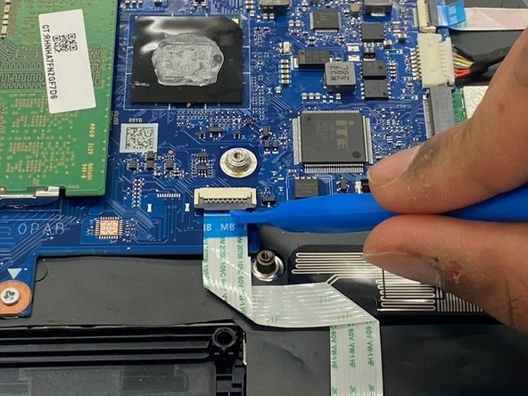

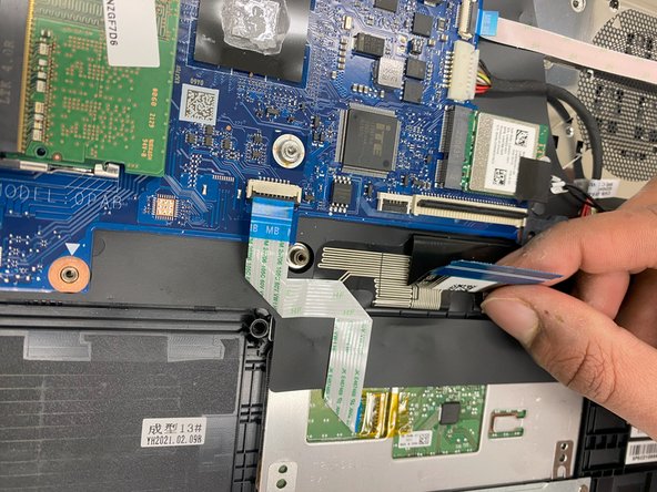

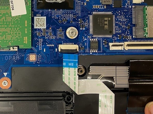

  6. HP 14-dq0051dx Motherboard Replacement: crwdns2935265:06crwdnd2935265:01crwdnd2935265:03crwdne2935265:0 HP 14-dq0051dx Motherboard Replacement: crwdns2935265:06crwdnd2935265:02crwdnd2935265:03crwdne2935265:0 HP 14-dq0051dx Motherboard Replacement: crwdns2935265:06crwdnd2935265:03crwdnd2935265:03crwdne2935265:0
    • Use the blue opening tool to flip up the small locking flap from the ZIF connector that attaches the touchpad cable to the motherboard.
    • Gently pull the ribbon cable out from the connector.

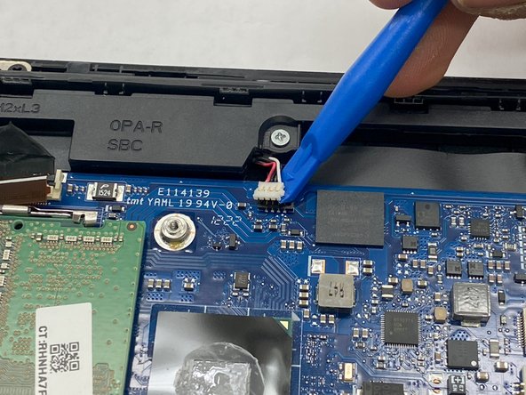

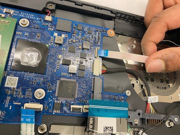

  7. HP 14-dq0051dx Motherboard Replacement: crwdns2935265:07crwdnd2935265:01crwdnd2935265:02crwdne2935265:0 HP 14-dq0051dx Motherboard Replacement: crwdns2935265:07crwdnd2935265:02crwdnd2935265:02crwdne2935265:0
    • Gently unplug the keyboard connector from the motherboard.
  8. HP 14-dq0051dx Motherboard Replacement: crwdns2935265:08crwdnd2935265:01crwdnd2935265:02crwdne2935265:0 HP 14-dq0051dx Motherboard Replacement: crwdns2935265:08crwdnd2935265:02crwdnd2935265:02crwdne2935265:0
    • Lift up the small compartment with your finger.
    • Pull the flat cable out of the connector.

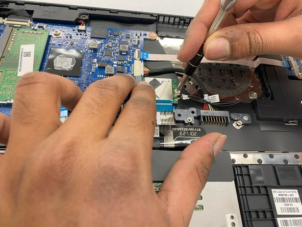

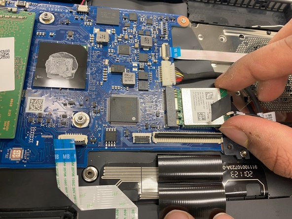

    • Lift the black square card covering two small cables connected to the WIFI card.
    • Unplug the small wires one and two with your fingers.
    • Use a Phillips #0 screwdriver to unscrew the single 1mm screw that secures the WIFI card.
    • Remove the WIFI card by gently pulling it out of its slot.

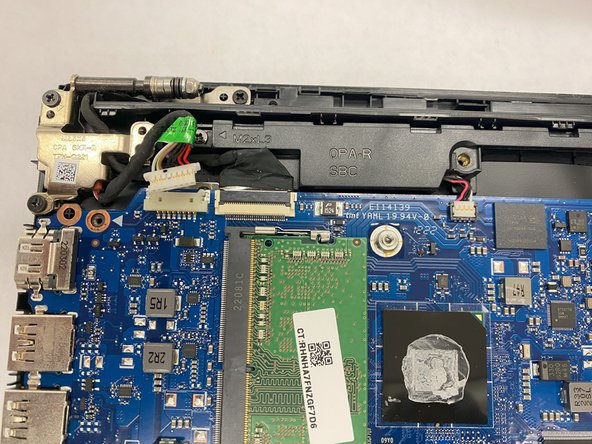

    • Pull the charging port cable away from the connector in the same direction as the individual wires to unplug the charge port connector.
    • Remove the charging port.
  12. HP 14-dq0051dx Motherboard Replacement: crwdns2935265:012crwdnd2935265:01crwdnd2935265:02crwdne2935265:0 HP 14-dq0051dx Motherboard Replacement: crwdns2935265:012crwdnd2935265:02crwdnd2935265:02crwdne2935265:0
    • Lift up the port using the blue opening tool.
    • Continue to lift up until it is unplugged from the motherboard.

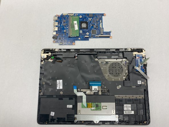

  13. HP 14-dq0051dx Motherboard Replacement: crwdns2935265:013crwdnd2935265:01crwdnd2935265:02crwdne2935265:0 HP 14-dq0051dx Motherboard Replacement: crwdns2935265:013crwdnd2935265:02crwdnd2935265:02crwdne2935265:0
    • Place both hands on opposite corners of the motherboard and carefully lift it up to remove it from the laptop.
    • Now the motherboard has been successfully removed and is ready to be replaced!
