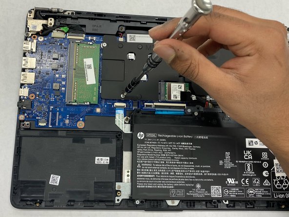

    • Use a Phillips #1 screwdriver to remove the five 2.5 mm screws that secure the motherboard cover.
    • Remove the motherboard cover from the laptop.

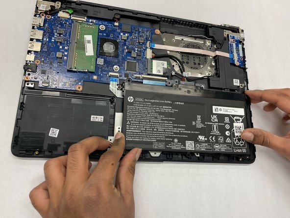

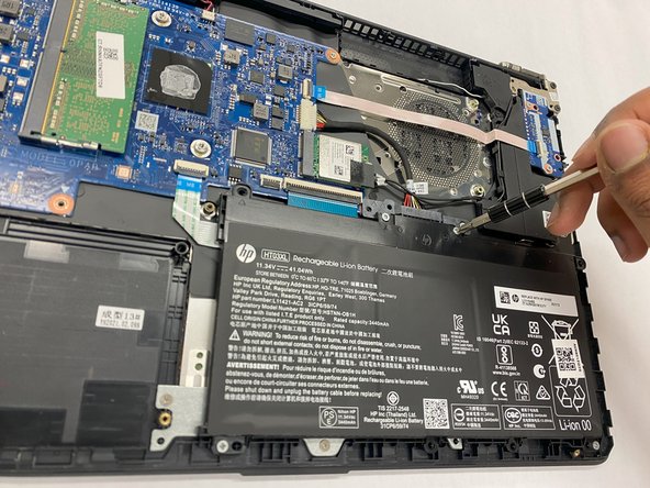

  5. HP 14-dq0051dx Keyboard Replacement: crwdns2935265:05crwdnd2935265:01crwdnd2935265:03crwdne2935265:0 HP 14-dq0051dx Keyboard Replacement: crwdns2935265:05crwdnd2935265:02crwdnd2935265:03crwdne2935265:0 HP 14-dq0051dx Keyboard Replacement: crwdns2935265:05crwdnd2935265:03crwdnd2935265:03crwdne2935265:0

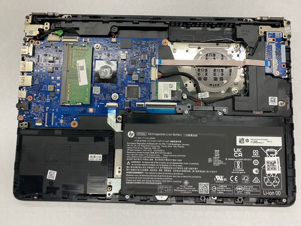

    • Use a Phillips #1 screwdriver to remove the four 2.5 mm screws that secure the battery.
    • Remove the battery from the laptop.

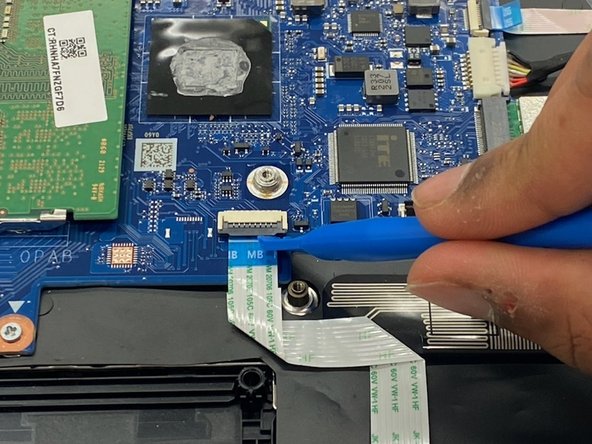

  6. HP 14-dq0051dx Keyboard Replacement: crwdns2935265:06crwdnd2935265:01crwdnd2935265:03crwdne2935265:0 HP 14-dq0051dx Keyboard Replacement: crwdns2935265:06crwdnd2935265:02crwdnd2935265:03crwdne2935265:0 HP 14-dq0051dx Keyboard Replacement: crwdns2935265:06crwdnd2935265:03crwdnd2935265:03crwdne2935265:0

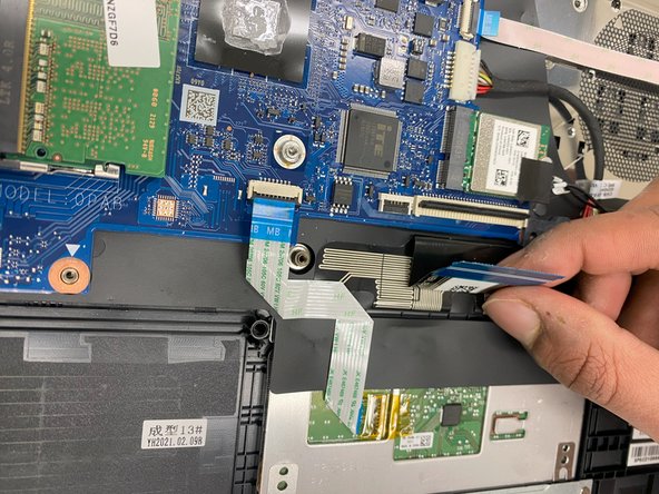

    • Use the blue opening tool to flip up the small locking flap from the ZIF connector that attaches the touchpad cable to the motherboard.
    • Gently pull the ribbon cable out from the connector.
    • Ensure that the connector is pulled out gently as this is connector is very easy to damage

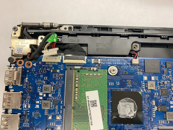

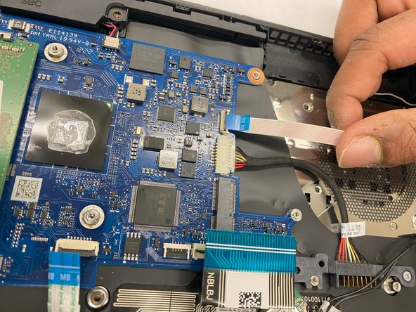

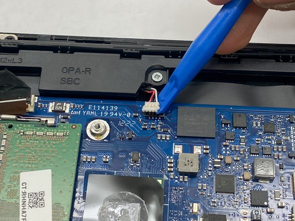

  7. HP 14-dq0051dx Keyboard Replacement: crwdns2935265:07crwdnd2935265:01crwdnd2935265:02crwdne2935265:0 HP 14-dq0051dx Keyboard Replacement: crwdns2935265:07crwdnd2935265:02crwdnd2935265:02crwdne2935265:0
    • Gently unplug the keyboard connector from the motherboard.
  8. HP 14-dq0051dx Keyboard Replacement: crwdns2935265:08crwdnd2935265:01crwdnd2935265:03crwdne2935265:0 HP 14-dq0051dx Keyboard Replacement: crwdns2935265:08crwdnd2935265:02crwdnd2935265:03crwdne2935265:0 HP 14-dq0051dx Keyboard Replacement: crwdns2935265:08crwdnd2935265:03crwdnd2935265:03crwdne2935265:0
    • Lift up the small compartment with your finger.
    • Pull the flat cable out of the connector.
  9. HP 14-dq0051dx Keyboard Replacement: crwdns2935265:09crwdnd2935265:01crwdnd2935265:03crwdne2935265:0 HP 14-dq0051dx Keyboard Replacement: crwdns2935265:09crwdnd2935265:02crwdnd2935265:03crwdne2935265:0 HP 14-dq0051dx Keyboard Replacement: crwdns2935265:09crwdnd2935265:03crwdnd2935265:03crwdne2935265:0

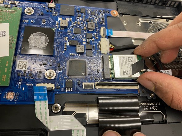

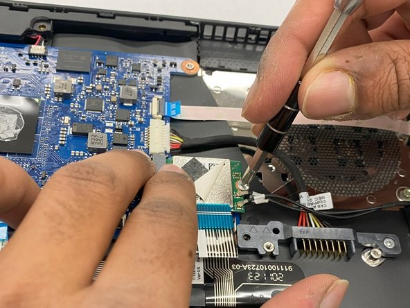

    • Use a Phillips #0 screwdriver to remove the single 1 mm screw that secure the WiFi card.
    • Pull the WiFi card out of its slot
    • Pull the WiFi card out slowly and gently as to not damage the card or the slot

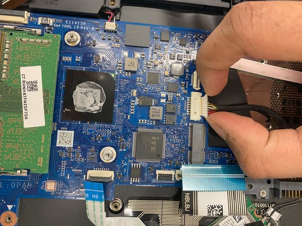

  10. HP 14-dq0051dx Keyboard Replacement: crwdns2935265:010crwdnd2935265:01crwdnd2935265:02crwdne2935265:0 HP 14-dq0051dx Keyboard Replacement: crwdns2935265:010crwdnd2935265:02crwdnd2935265:02crwdne2935265:0
    • Pull the charging port cable away from the connector in the same direction as the individual wires to unplug the charge port connector.
    • Remove the charging port.

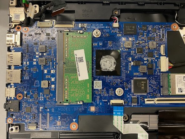

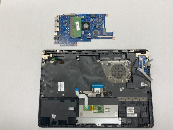

  12. HP 14-dq0051dx Keyboard Replacement: crwdns2935265:012crwdnd2935265:01crwdnd2935265:02crwdne2935265:0 HP 14-dq0051dx Keyboard Replacement: crwdns2935265:012crwdnd2935265:02crwdnd2935265:02crwdne2935265:0
    • Place both hands on opposite corners of the motherboard and carefully lift it up to remove it from the laptop.
    • Now the motherboard has been successfully removed and is ready to be replaced!

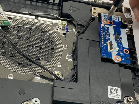

  14. HP 14-dq0051dx Keyboard Replacement: crwdns2935265:014crwdnd2935265:01crwdnd2935265:03crwdne2935265:0 HP 14-dq0051dx Keyboard Replacement: crwdns2935265:014crwdnd2935265:02crwdnd2935265:03crwdne2935265:0 HP 14-dq0051dx Keyboard Replacement: crwdns2935265:014crwdnd2935265:03crwdnd2935265:03crwdne2935265:0
    • Remove the signle 2 mm screws that secure the side cover using a Phillips #0 screwdriver.
    • Pull the side cover off gently

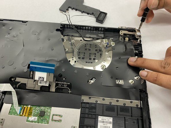

  15. HP 14-dq0051dx Keyboard Replacement: crwdns2935265:015crwdnd2935265:01crwdnd2935265:03crwdne2935265:0 HP 14-dq0051dx Keyboard Replacement: crwdns2935265:015crwdnd2935265:02crwdnd2935265:03crwdne2935265:0 HP 14-dq0051dx Keyboard Replacement: crwdns2935265:015crwdnd2935265:03crwdnd2935265:03crwdne2935265:0

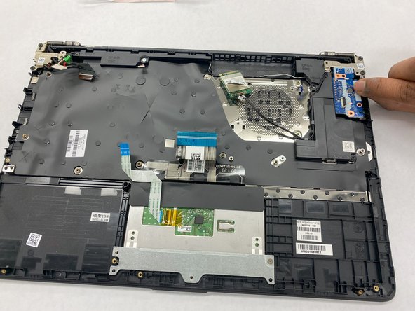

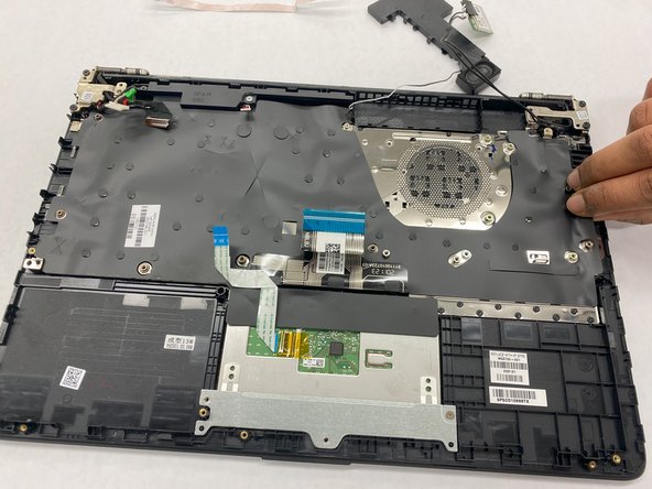

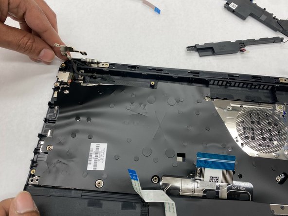

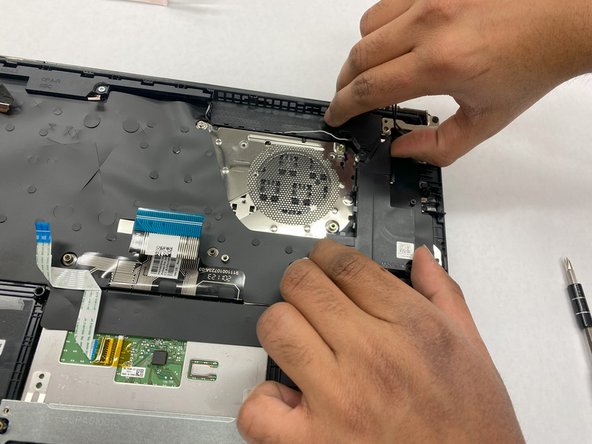

    • Remove the six 2.5 mm screws that secure the keyboard to its hinges using a Phillips #1 screwdriver.
    • Once unscrewed, pull the hinge tabs upward gently using your hands
  16. HP 14-dq0051dx Keyboard Replacement: crwdns2935265:016crwdnd2935265:01crwdnd2935265:01crwdne2935265:0
    • Place both hands on opposite corners of the keyboard and carefully lift it off the laptop
