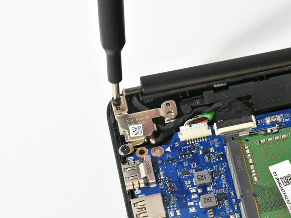

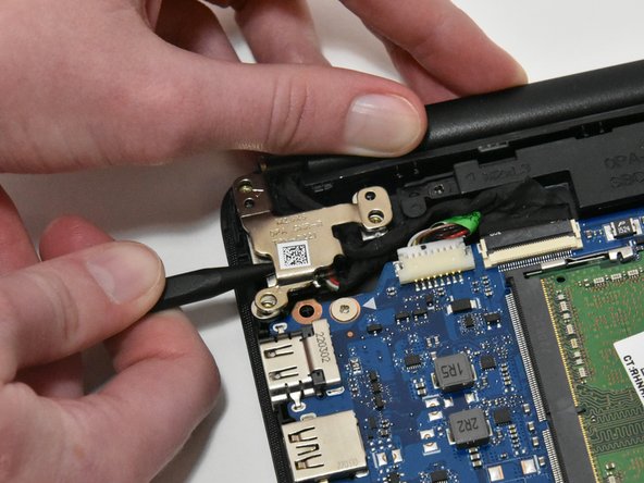

  5. HP 14-dq0051dx Charging Port Replacement, Charging Port: crwdns2935265:05crwdnd2935265:01crwdnd2935265:03crwdne2935265:0 HP 14-dq0051dx Charging Port Replacement, Charging Port: crwdns2935265:05crwdnd2935265:02crwdnd2935265:03crwdne2935265:0 HP 14-dq0051dx Charging Port Replacement, Charging Port: crwdns2935265:05crwdnd2935265:03crwdnd2935265:03crwdne2935265:0
    • Use a Phillips #1 screwdriver to remove the two 4.5 mm screws from the left hinge.
    • Rotate the hinge up and out of the way.

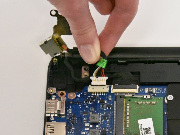

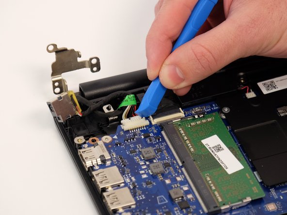

  6. HP 14-dq0051dx Charging Port Replacement: crwdns2935265:06crwdnd2935265:01crwdnd2935265:03crwdne2935265:0 HP 14-dq0051dx Charging Port Replacement: crwdns2935265:06crwdnd2935265:02crwdnd2935265:03crwdne2935265:0 HP 14-dq0051dx Charging Port Replacement: crwdns2935265:06crwdnd2935265:03crwdnd2935265:03crwdne2935265:0
    • Pull the charging port cable away from the connector in the same direction as the individual wires to unplug the charge port connector.
    • Pull evenly on the full width of the cable so that no individual wires are overly strained.
    • Remove the charging port.
