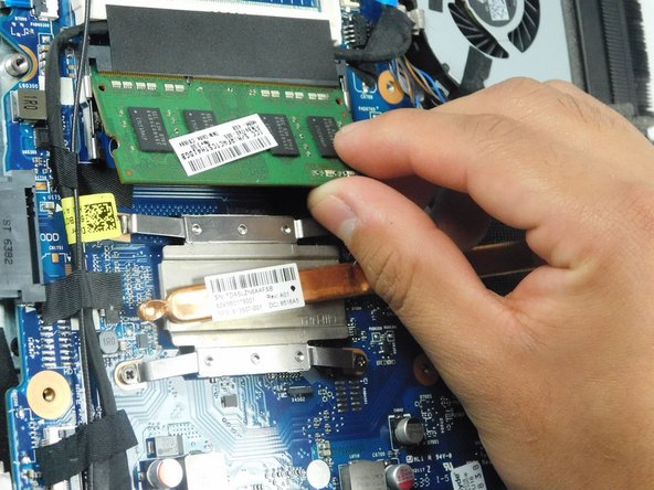

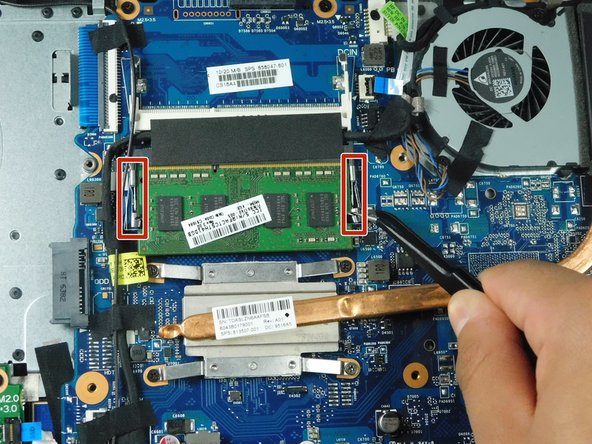

  3. HP 14-an012nr RAM Replacement, RAM: crwdns2935265:03crwdnd2935265:01crwdnd2935265:03crwdne2935265:0 HP 14-an012nr RAM Replacement, RAM: crwdns2935265:03crwdnd2935265:02crwdnd2935265:03crwdne2935265:0 HP 14-an012nr RAM Replacement, RAM: crwdns2935265:03crwdnd2935265:03crwdnd2935265:03crwdne2935265:0
    • Push the two silver retaining arms apart at the same time.
    • As soon as the RAM pops out, remove it.
    • When removing or reinserting the RAM, be careful as to avoiding scratching or damaging the RAM.
