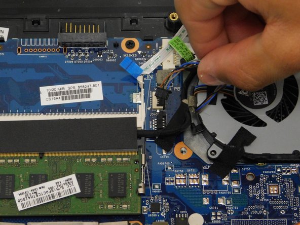

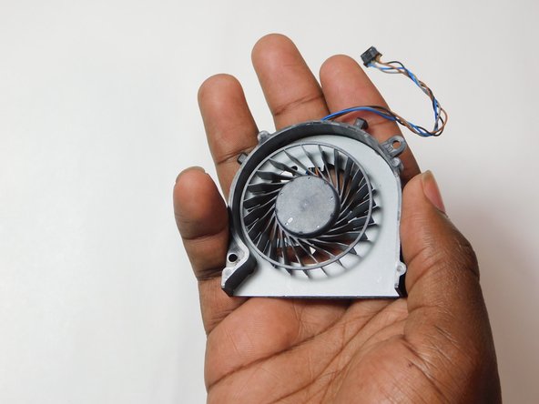

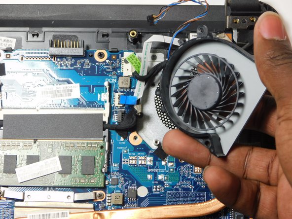

  3. HP 14-an012nr Fan Replacement, Fan: crwdns2935265:03crwdnd2935265:01crwdnd2935265:03crwdne2935265:0 HP 14-an012nr Fan Replacement, Fan: crwdns2935265:03crwdnd2935265:02crwdnd2935265:03crwdne2935265:0 HP 14-an012nr Fan Replacement, Fan: crwdns2935265:03crwdnd2935265:03crwdnd2935265:03crwdne2935265:0
    • Remove the two 3 mm screws that secure the fan.
    • Gently disconnect the power cable; it can tear easily.
    • Remove the fan.
  4. HP 14-an012nr Fan Replacement: crwdns2935265:04crwdnd2935265:01crwdnd2935265:02crwdne2935265:0 HP 14-an012nr Fan Replacement: crwdns2935265:04crwdnd2935265:02crwdnd2935265:02crwdne2935265:0
    • Clean the area where the fan was located with a clean soft cloth or cotton swab.
    • Once cleaned and free of dust place the new fan and follow the steps in reverse to rebuild the laptop.
