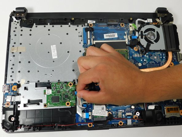

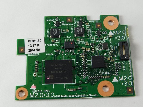

  3. HP 14-an012nr Daughterboard Replacement, Daughterboard: crwdns2935265:03crwdnd2935265:01crwdnd2935265:03crwdne2935265:0 HP 14-an012nr Daughterboard Replacement, Daughterboard: crwdns2935265:03crwdnd2935265:02crwdnd2935265:03crwdne2935265:0 HP 14-an012nr Daughterboard Replacement, Daughterboard: crwdns2935265:03crwdnd2935265:03crwdnd2935265:03crwdne2935265:0
    • Remove the three 4 mm screws holding the daughterboard down using a Phillips #00 screwdriver.
    • Remove the ribbon cable by gently pressing on the blue tab and pulling on the plastic reinforcement at the end of the cable.
    • Be careful when removing the cable as pulling with too much force can damage both the cable and connector.
    • Remove the daughterboard.
