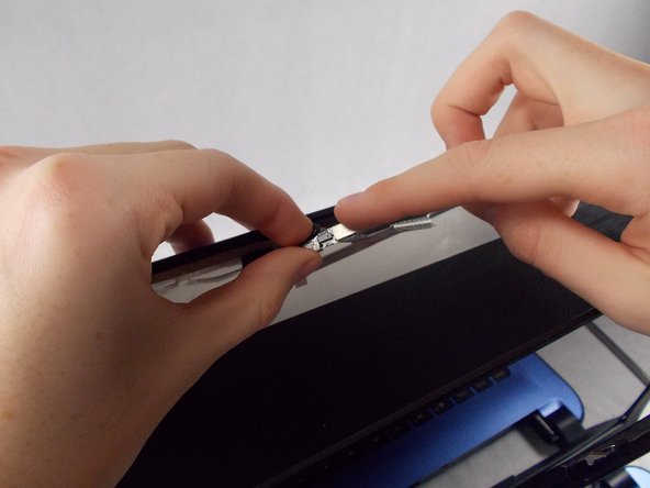

  4. HP 14-am052nr Webcam Replacement: crwdns2935265:04crwdnd2935265:01crwdnd2935265:02crwdne2935265:0 HP 14-am052nr Webcam Replacement: crwdns2935265:04crwdnd2935265:02crwdnd2935265:02crwdne2935265:0
    • Carefully detach the webcam using your fingers.
  5. HP 14-am052nr Webcam Replacement: crwdns2935265:05crwdnd2935265:01crwdnd2935265:01crwdne2935265:0
    • Detach the webcam pin connector and completely remove the webcam from the device.
