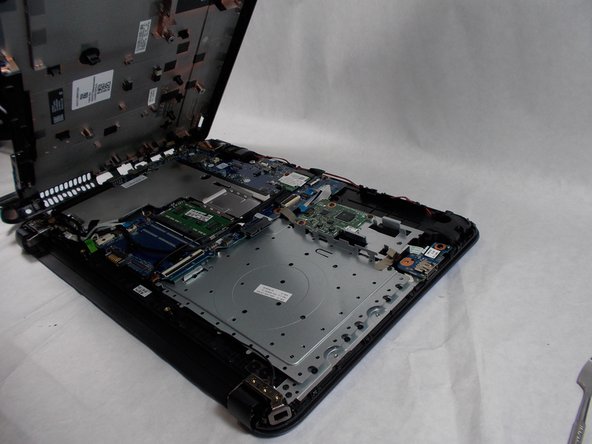

    2. HP 14-am052nr RAM Replacement: crwdns2935265:03crwdnd2935265:01crwdnd2935265:02crwdne2935265:0 HP 14-am052nr RAM Replacement: crwdns2935265:03crwdnd2935265:02crwdnd2935265:02crwdne2935265:0
      • Use a prying tool to remove the back panel from the base of the computer.
    1. HP 14-am052nr RAM Replacement, RAM: crwdns2935265:04crwdnd2935265:01crwdnd2935265:01crwdne2935265:0
      • Push the two silver tabs on the sides of the RAM away from each other.
      • The RAM should now be loose and pointed upwards.
    2. HP 14-am052nr RAM Replacement: crwdns2935265:05crwdnd2935265:01crwdnd2935265:01crwdne2935265:0
      • Gently lift and remove the RAM stick at a 45 degree angle from the laptop.
