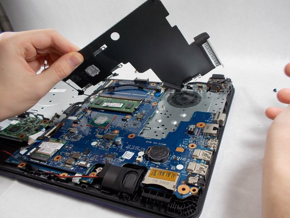

    2. HP 14-am052nr Keyboard Replacement: crwdns2935265:05crwdnd2935265:01crwdnd2935265:02crwdne2935265:0 HP 14-am052nr Keyboard Replacement: crwdns2935265:05crwdnd2935265:02crwdnd2935265:02crwdne2935265:0
      • Using the Phillips #0 screwdriver, remove four 1.5 mm screws from the silver cover.
      • Remove the silver cover from the device.

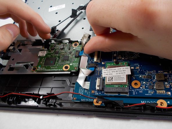

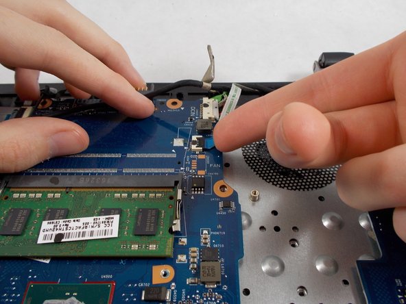

    3. HP 14-am052nr Keyboard Replacement: crwdns2935265:06crwdnd2935265:01crwdnd2935265:03crwdne2935265:0 HP 14-am052nr Keyboard Replacement: crwdns2935265:06crwdnd2935265:02crwdnd2935265:03crwdne2935265:0 HP 14-am052nr Keyboard Replacement: crwdns2935265:06crwdnd2935265:03crwdnd2935265:03crwdne2935265:0
      • Unplug all connectors attached to the motherboard.
    4. HP 14-am052nr Keyboard Replacement: crwdns2935265:07crwdnd2935265:01crwdnd2935265:01crwdne2935265:0
      • Once all plugs and screws disconnected, remove the motherboard from the device.

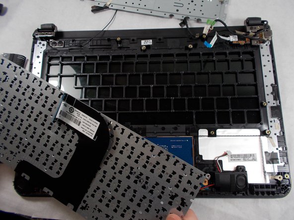

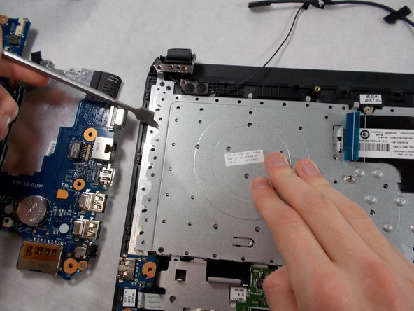

    1. HP 14-am052nr Keyboard Replacement, Keyboard: crwdns2935265:08crwdnd2935265:01crwdnd2935265:02crwdne2935265:0 HP 14-am052nr Keyboard Replacement, Keyboard: crwdns2935265:08crwdnd2935265:02crwdnd2935265:02crwdne2935265:0
      • Carefully pry up the metal plate and detach it from the base.
    2. HP 14-am052nr Keyboard Replacement: crwdns2935265:09crwdnd2935265:01crwdnd2935265:01crwdne2935265:0
      • Pull the plate away from the base while pulling the keyboard connecting cable through.
    3. HP 14-am052nr Keyboard Replacement: crwdns2935265:010crwdnd2935265:01crwdnd2935265:02crwdne2935265:0 HP 14-am052nr Keyboard Replacement: crwdns2935265:010crwdnd2935265:02crwdnd2935265:02crwdne2935265:0
      • Pull the keyboard out carefully from the base.
