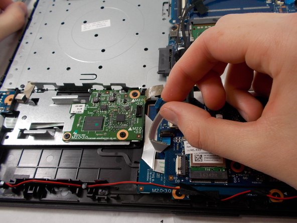

  4. HP 14-am052nr Daughterboard Replacement, Daughterboard: crwdns2935265:04crwdnd2935265:01crwdnd2935265:02crwdne2935265:0 HP 14-am052nr Daughterboard Replacement, Daughterboard: crwdns2935265:04crwdnd2935265:02crwdnd2935265:02crwdne2935265:0
    • Disconnect the daughterboard from the connector with your thumb and pointer finger.
  5. HP 14-am052nr Daughterboard Replacement: crwdns2935265:05crwdnd2935265:01crwdnd2935265:01crwdne2935265:0
    • Use the Phillips #0 screwdriver to remove three 3 mm screws.
  6. HP 14-am052nr Daughterboard Replacement: crwdns2935265:06crwdnd2935265:01crwdnd2935265:01crwdne2935265:0
    • Remove the daughterboard from the device.
