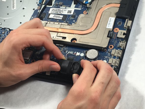

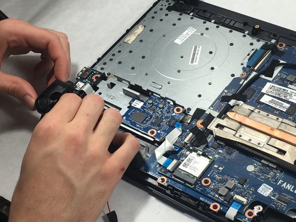

  5. HP 14-ac151nr Internal Speakers Replacement, Internal Speakers: crwdns2935265:05crwdnd2935265:01crwdnd2935265:03crwdne2935265:0 HP 14-ac151nr Internal Speakers Replacement, Internal Speakers: crwdns2935265:05crwdnd2935265:02crwdnd2935265:03crwdne2935265:0 HP 14-ac151nr Internal Speakers Replacement, Internal Speakers: crwdns2935265:05crwdnd2935265:03crwdnd2935265:03crwdne2935265:0
    • Disconnect the speakers from motherboard.
    • Remove the speakers by lifting them straight upward.
