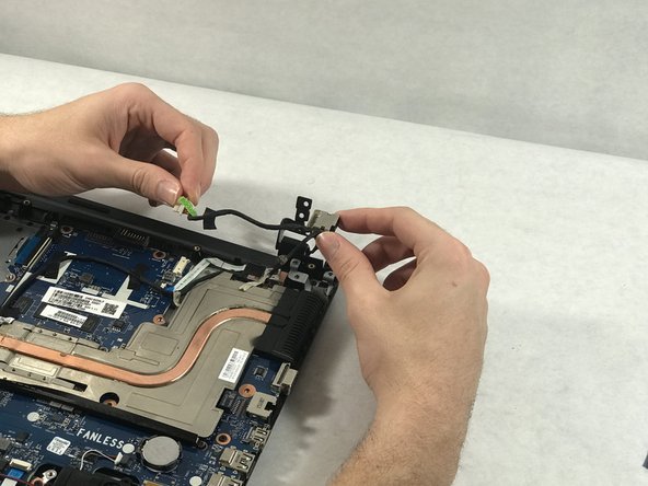

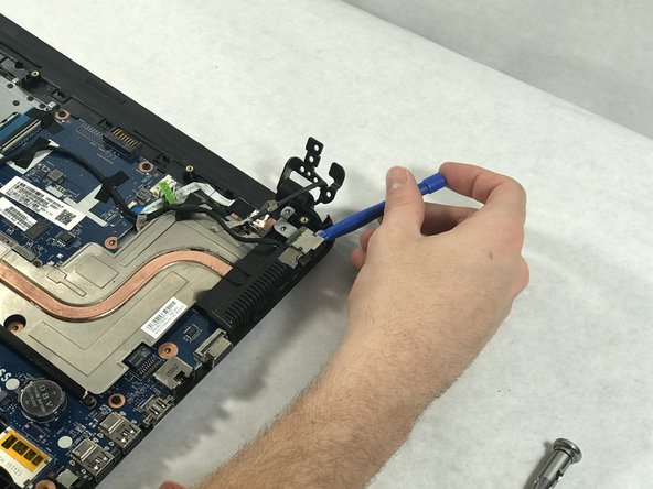

  7. HP 14-ac151nr DC Power Jack Replacement: crwdns2935265:07crwdnd2935265:01crwdnd2935265:03crwdne2935265:0 HP 14-ac151nr DC Power Jack Replacement: crwdns2935265:07crwdnd2935265:02crwdnd2935265:03crwdne2935265:0 HP 14-ac151nr DC Power Jack Replacement: crwdns2935265:07crwdnd2935265:03crwdnd2935265:03crwdne2935265:0
    • Disconnect the power jack from the motherboard.
    • Remove the power jack by lifting it up.
    • An opener tool may make this easier.
