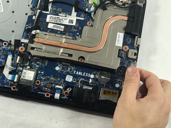

    • Remove battery by pushing the two buttons inward.
  2. HP 14-ac151nr Coin Cell Battery Replacement: crwdns2935265:02crwdnd2935265:01crwdnd2935265:01crwdne2935265:0
    • Remove the two rubber feet next to the battery.
  3. HP 14-ac151nr Coin Cell Battery Replacement: crwdns2935265:03crwdnd2935265:01crwdnd2935265:01crwdne2935265:0
    • Remove all 14 Phillips head #0 screws.
  4. HP 14-ac151nr Coin Cell Battery Replacement: crwdns2935265:04crwdnd2935265:01crwdnd2935265:01crwdne2935265:0
    • Use a plastic opener tool to pry off the black backplate.
  5. HP 14-ac151nr Coin Cell Battery Replacement, Coin Cell Battery: crwdns2935265:05crwdnd2935265:01crwdnd2935265:01crwdne2935265:0
    • Use a spudger and a plastic opener to push back the lock holding the battery in place.
  6. HP 14-ac151nr Coin Cell Battery Replacement: crwdns2935265:06crwdnd2935265:01crwdnd2935265:02crwdne2935265:0 HP 14-ac151nr Coin Cell Battery Replacement: crwdns2935265:06crwdnd2935265:02crwdnd2935265:02crwdne2935265:0
    • Remove the battery by pushing back the lock with the wedge while pulling the battery up.
