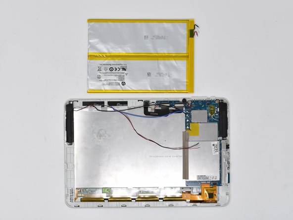

  5. HP 10 2101 Battery Replacement, Battery: crwdns2935265:05crwdnd2935265:01crwdnd2935265:01crwdne2935265:0
    • Desolder the battery connectors from the motherboard.
  6. HP 10 2101 Battery Replacement: crwdns2935265:06crwdnd2935265:01crwdnd2935265:01crwdne2935265:0
    • Pull the bright blue-green tabs to remove the battery from the rest of the device.
    • Pulling the tabs may not fully disconnect the battery from the metal display casing.
  7. HP 10 2101 Battery Replacement: crwdns2935265:07crwdnd2935265:01crwdnd2935265:02crwdne2935265:0 HP 10 2101 Battery Replacement: crwdns2935265:07crwdnd2935265:02crwdnd2935265:02crwdne2935265:0
    • If the previous step is unsuccessful, wedge the smallest plastic opening tool between the adhesive and the metal display casing.
    • Wedging may apply unsafe pressure on the battery. Be careful not to puncture the battery.
