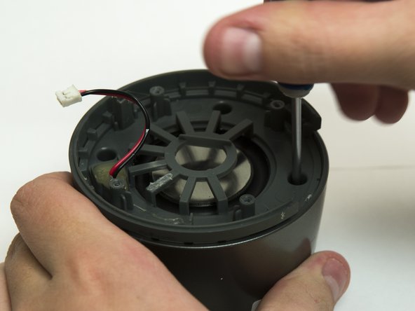

  7. HMDX Jam Plus Speaker Replacement, Speaker: crwdns2935265:07crwdnd2935265:01crwdnd2935265:02crwdne2935265:0 HMDX Jam Plus Speaker Replacement, Speaker: crwdns2935265:07crwdnd2935265:02crwdnd2935265:02crwdne2935265:0
    • Use a Phillips #1 screwdriver to remove the four black 9mm screws from device.
  8. HMDX Jam Plus Speaker Replacement: crwdns2935265:08crwdnd2935265:01crwdnd2935265:01crwdne2935265:0
    • Use the plastic opening tool to pry the glue away from the wire. Be careful not to damage the wire.

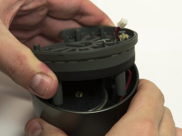

  9. HMDX Jam Plus Speaker Replacement: crwdns2935265:09crwdnd2935265:01crwdnd2935265:02crwdne2935265:0 HMDX Jam Plus Speaker Replacement: crwdns2935265:09crwdnd2935265:02crwdnd2935265:02crwdne2935265:0
    • Use the plastic opening tool to separate the center plastic piece from the rest of the device.
    • Gently lift the center plastic piece and feed the speaker wire through the hole.

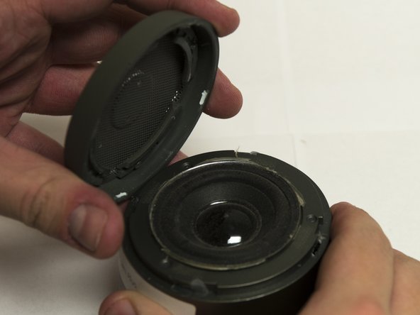

  10. HMDX Jam Plus Speaker Replacement: crwdns2935265:010crwdnd2935265:01crwdnd2935265:02crwdne2935265:0 HMDX Jam Plus Speaker Replacement: crwdns2935265:010crwdnd2935265:02crwdnd2935265:02crwdne2935265:0
    • Use the plastic opening tool to separate the speaker grate from the rest of the device.

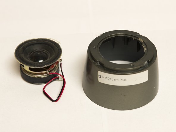

  11. HMDX Jam Plus Speaker Replacement: crwdns2935265:011crwdnd2935265:01crwdnd2935265:02crwdne2935265:0 HMDX Jam Plus Speaker Replacement: crwdns2935265:011crwdnd2935265:02crwdnd2935265:02crwdne2935265:0
    • Carefully remove the speaker through the top of the device.
    • Apply new adhesive to the edge of the replacement speaker and the edge of the speaker grate to ensure they do not wiggle loose.
