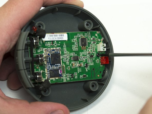

    • Carefully use the plastic opening tool to remove the glue around the battery and speaker connectors.
    • Pull gently on the connectors to separate each one from the main board.
    • The battery is connected to board in the red socket and the speaker is connected in the white socket.

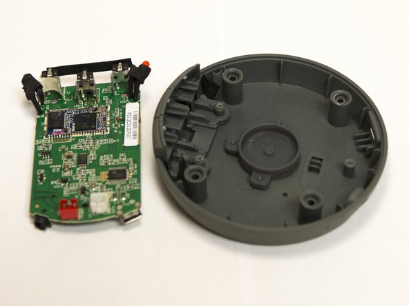

    • Remove the three black 6mm screws from the main board using a Philips #00 screwdriver.
  8. HMDX Jam Plus  Micro USB Jack Replacement: crwdns2935265:08crwdnd2935265:01crwdnd2935265:02crwdne2935265:0 HMDX Jam Plus  Micro USB Jack Replacement: crwdns2935265:08crwdnd2935265:02crwdnd2935265:02crwdne2935265:0
    • Carefully lift the main board away from the plastic.
    • Lift the side with the buttons first and be careful not to damage the Line In Jack or the Micro USB Jack.
  9. HMDX Jam Plus  Micro USB Jack Replacement: crwdns2935265:09crwdnd2935265:01crwdnd2935265:01crwdne2935265:0
    • Use the Micro soldering iron to heat up each pad and use the desoldering wick to wick up the melted solder.
    • The surface mount jack should pull from the surface without much force. Use tweezers to apply upward pressure on on the jack.
    • Do not apply too much heat to the board as it may damage other portions of the board.
