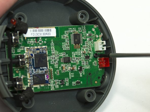

  4. HMDX Jam Plus  Line In Jack Replacement: crwdns2935265:04crwdnd2935265:01crwdnd2935265:03crwdne2935265:0 HMDX Jam Plus  Line In Jack Replacement: crwdns2935265:04crwdnd2935265:02crwdnd2935265:03crwdne2935265:0 HMDX Jam Plus  Line In Jack Replacement: crwdns2935265:04crwdnd2935265:03crwdnd2935265:03crwdne2935265:0
    • Carefully use the plastic opening tool to remove the glue around the battery and speaker connectors.
    • Pull gently on the connectors to separate each one from the main board.
    • The battery is connected to board in the red socket and the speaker is connected in the white socket.

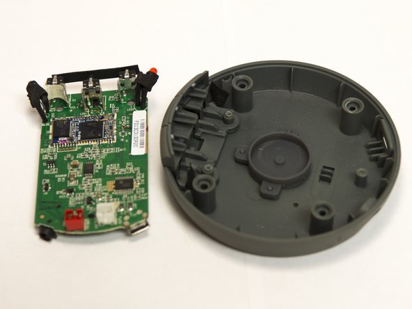

  8. HMDX Jam Plus  Line In Jack Replacement: crwdns2935265:08crwdnd2935265:01crwdnd2935265:02crwdne2935265:0 HMDX Jam Plus  Line In Jack Replacement: crwdns2935265:08crwdnd2935265:02crwdnd2935265:02crwdne2935265:0
    • Carefully lift the main board away from the plastic.
    • Lift the side with the buttons first and be careful not to damage the Line In Jack or the Micro USB Jack.
