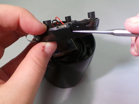

    1. HMDX Chill Front Buttons Replacement, Front Buttons: crwdns2935265:04crwdnd2935265:01crwdnd2935265:01crwdne2935265:0
      • Using a metal spudger, push the small latch upwards towards the button from the bottom of the base.
      • These are located underneath the rubber base, prior to removal.
    2. HMDX Chill Front Buttons Replacement: crwdns2935265:05crwdnd2935265:01crwdnd2935265:02crwdne2935265:0 HMDX Chill Front Buttons Replacement: crwdns2935265:05crwdnd2935265:02crwdnd2935265:02crwdne2935265:0
      • Insert a spudger into the slit between the bottom of the buttons and the speaker base.
      • Push the buttons upwards, away from the base, until they come loose.
      • Use your hand to pull the linked buttons off the base.
