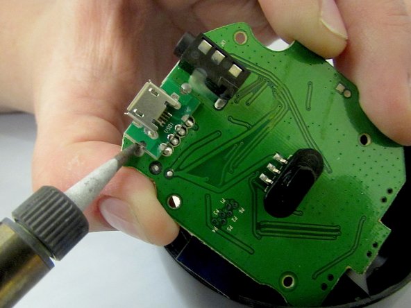

HMDX Chill Charging Port Replacement
    1. HMDX Chill Charging Port Replacement, Remove Rubber Base: crwdns2935265:01crwdnd2935265:01crwdnd2935265:03crwdne2935265:0 HMDX Chill Charging Port Replacement, Remove Rubber Base: crwdns2935265:01crwdnd2935265:02crwdnd2935265:03crwdne2935265:0 HMDX Chill Charging Port Replacement, Remove Rubber Base: crwdns2935265:01crwdnd2935265:03crwdnd2935265:03crwdne2935265:0
      • Insert a metal spudger under the rubber base.
      • Pry the rubber base off.
    2. HMDX Chill Charging Port Replacement: crwdns2935265:02crwdnd2935265:01crwdnd2935265:01crwdne2935265:0
      • Use a Phillips #1 screwdriver to remove four 9 mm screws from the base of the device.
    3. HMDX Chill Charging Port Replacement: crwdns2935265:03crwdnd2935265:01crwdnd2935265:02crwdne2935265:0 HMDX Chill Charging Port Replacement: crwdns2935265:03crwdnd2935265:02crwdnd2935265:02crwdne2935265:0
      • Grip the base of the HMDX Chill.
      • Pull the base upwards.
    1. HMDX Chill Charging Port Replacement, Motherboard: crwdns2935265:04crwdnd2935265:01crwdnd2935265:03crwdne2935265:0 HMDX Chill Charging Port Replacement, Motherboard: crwdns2935265:04crwdnd2935265:02crwdnd2935265:03crwdne2935265:0 HMDX Chill Charging Port Replacement, Motherboard: crwdns2935265:04crwdnd2935265:03crwdnd2935265:03crwdne2935265:0
      • Use a Phillips #1 screwdriver to remove the four 6 mm screws that secure the motherboard to the base of the device.
    2. HMDX Chill Charging Port Replacement: crwdns2935265:05crwdnd2935265:01crwdnd2935265:01crwdne2935265:0
      • Pull the motherboard away from the base gently.
      • Do not pull too hard on the motherboard. It is still attached to the base by wires.
    3. HMDX Chill Charging Port Replacement: crwdns2935265:06crwdnd2935265:01crwdnd2935265:03crwdne2935265:0 HMDX Chill Charging Port Replacement: crwdns2935265:06crwdnd2935265:02crwdnd2935265:03crwdne2935265:0 HMDX Chill Charging Port Replacement: crwdns2935265:06crwdnd2935265:03crwdnd2935265:03crwdne2935265:0
      • Use a soldering iron to desolder the wires connecting the motherboard to the case.
    4. HMDX Chill Charging Port Replacement: crwdns2935265:07crwdnd2935265:01crwdnd2935265:02crwdne2935265:0 HMDX Chill Charging Port Replacement: crwdns2935265:07crwdnd2935265:02crwdnd2935265:02crwdne2935265:0
      • Insert the spudger between the case and the wire and move the spudger upwards.
      • This will cause the case to prop open.
      • The wire behind the motherboard will now be visible. Pull this out from behind.
    5. HMDX Chill Charging Port Replacement: crwdns2935265:08crwdnd2935265:01crwdnd2935265:01crwdne2935265:0
      • Use the soldering iron to desolder the wires connecting the motherboard to the base of the HMDX Chill.
    1. HMDX Chill Charging Port Replacement, Desolder the Charging Port: crwdns2935265:09crwdnd2935265:01crwdnd2935265:02crwdne2935265:0 HMDX Chill Charging Port Replacement, Desolder the Charging Port: crwdns2935265:09crwdnd2935265:02crwdnd2935265:02crwdne2935265:0
      • Using a soldering tool, desolder the charging port from the motherboard.
