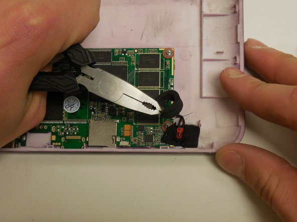

    • Gently grasp the foam ring with pliers and pull upwards to release the adhesive on the bottom of the ring.
    • The foam ring is delicate and can tear if handled improperly or with too much force.

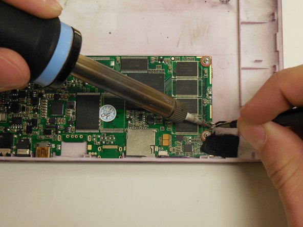

    • Using a soldering iron apply heat to the connection point between the LED and PCB.
    • Solder can be hot and may release toxic fumes. Be familiar with soldering safety guidelines before beginning this step.
    • When the solder is heated sufficiently (turns liquid and shiny) remove the LED lead with tweezers.
    • Repeat for other connection point.

    • Using a soldering iron apply heat to the connection point where the LED connects to the PCB.
    • When the solder is heated sufficiently (turns liquid and shiny) insert the LED lead with tweezers. If necessary add additional solder to ensure a solid electrical connection.
    • When connecting the new LED attach the longer lead to the positive connection point (denoted on the PCB by '+'), and the shorter lead to the negative (denoted by '-').
    • Repeat for the other connection point.
    • If the LED is connected backwards the LED will not work.
