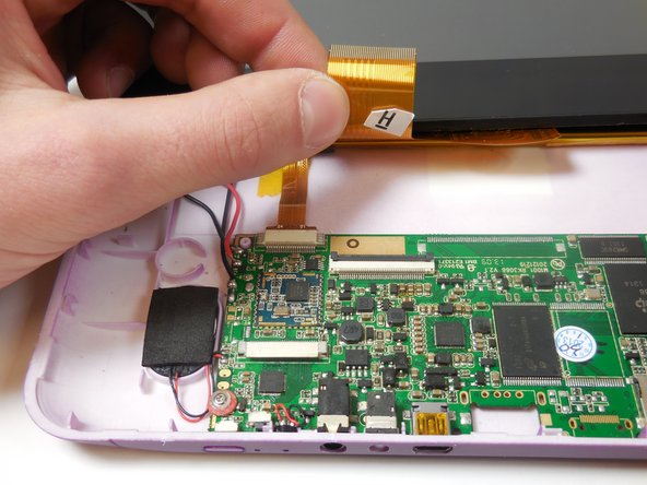

  2. HKC P886A LCD Replacement: crwdns2935265:02crwdnd2935265:01crwdnd2935265:02crwdne2935265:0 HKC P886A LCD Replacement: crwdns2935265:02crwdnd2935265:02crwdnd2935265:02crwdne2935265:0
    • The device is oriented with the camera to the right and the external button towards the top of the picture.
    • Locate the shorter ribbon cable and the black pressure tabs that hold the ribbon cable in place.
    • The tabs used to connect the ribbon cables are fragile and can easily be damaged.
    • Use the plastic spudger to gently slide the tabs about 2mm away from connector.
    • Once tabs are successfully disconnected the ribbon cable should come out of the port without resistance.

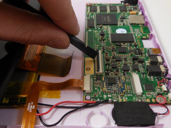

  3. HKC P886A LCD Replacement: crwdns2935265:03crwdnd2935265:01crwdnd2935265:03crwdne2935265:0 HKC P886A LCD Replacement: crwdns2935265:03crwdnd2935265:02crwdnd2935265:03crwdne2935265:0 HKC P886A LCD Replacement: crwdns2935265:03crwdnd2935265:03crwdnd2935265:03crwdne2935265:0
    • Locate the longer ribbon cable and the pressure clamp that holds the cable in the connection port.
    • Using the plastic spudger, flip the black locking clip up.
    • The pressure clip will click when it has been disengaged.
    • Once the clip is unlocked, the cable should slide out without resistance
    • In photo 1 the device is oriented with the camera to the left and external buttons towards the bottom. In photo 2 the device is oriented with the camera toward the user. In photo 3 the camera is to the left.

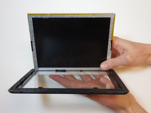

  4. HKC P886A LCD Replacement, LCD: crwdns2935265:04crwdnd2935265:01crwdnd2935265:02crwdne2935265:0 HKC P886A LCD Replacement, LCD: crwdns2935265:04crwdnd2935265:02crwdnd2935265:02crwdne2935265:0
    • The screen assembly is a delicate component and some prying is involved. Avoid deforming screen to avoid further damage.
    • Gently bend the matrix away from the screen to release the pressure clamps.
    • Bend one side at a time applying equal force in order to reduce stress on the matrix from the bending.
    • Once all pressure clamps are disengaged, separate the screen and matrix without touching the front of either component.
    • Replacement matrices can be found at this link: screensurgeons.com
  5. HKC P886A LCD Replacement: crwdns2935265:05crwdnd2935265:01crwdnd2935265:01crwdne2935265:0
    • To reassemble to display, seat the LCD screen in the pressure clamps and gently push components together.
    • Do not touch the front of the matrix or screen to avoid getting fingerprints and smudges on device.
