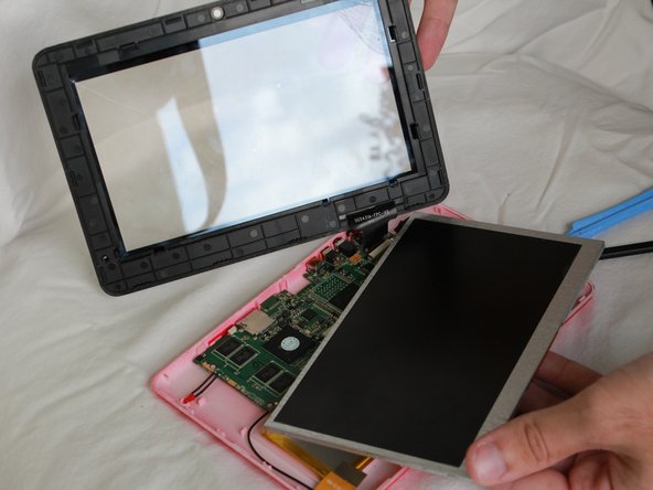

    • Insert the plastic opening tool between the digitizer and the case.
    • Place the spudger in the gap created by the plastic opening tool to assist in separation.
  2. HKC P776A Screen Replacement: crwdns2935265:02crwdnd2935265:01crwdnd2935265:02crwdne2935265:0 HKC P776A Screen Replacement: crwdns2935265:02crwdnd2935265:02crwdnd2935265:02crwdne2935265:0
    • Slide the spudger along the perimeter of the device to fully separate the two pieces.
  3. HKC P776A Screen Replacement, Separating the Screen and Digitizer: crwdns2935265:03crwdnd2935265:01crwdnd2935265:02crwdne2935265:0 HKC P776A Screen Replacement, Separating the Screen and Digitizer: crwdns2935265:03crwdnd2935265:02crwdnd2935265:02crwdne2935265:0
    • Use your fingers to pop the screen out from the digitizer.
  4. HKC P776A Screen Replacement, Removing the Optical Cord from the Motherbaord: crwdns2935265:04crwdnd2935265:01crwdnd2935265:01crwdne2935265:0
    • With the plastic opening tool, lift the black latch up.
  5. HKC P776A Screen Replacement: crwdns2935265:05crwdnd2935265:01crwdnd2935265:01crwdne2935265:0
    • Pull the optical cord out from the motherboard.
