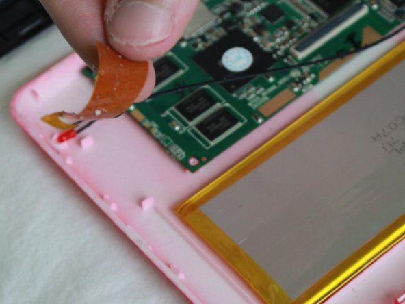

  11. HKC P776A Motherboard Replacement, Wifi Antenna: crwdns2935265:011crwdnd2935265:01crwdnd2935265:02crwdne2935265:0 HKC P776A Motherboard Replacement, Wifi Antenna: crwdns2935265:011crwdnd2935265:02crwdnd2935265:02crwdne2935265:0
    • Peel off the tape that is attaching the wifi antenna to the case.

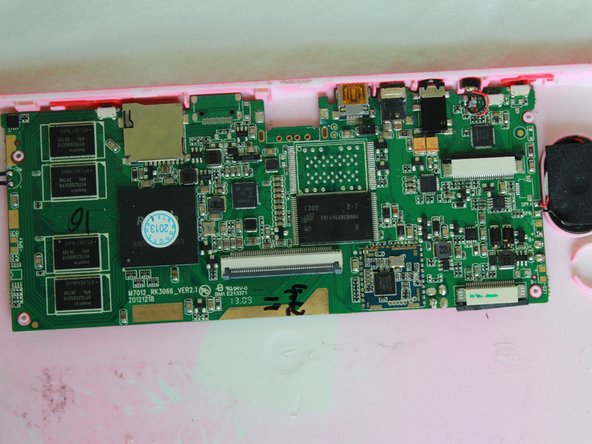

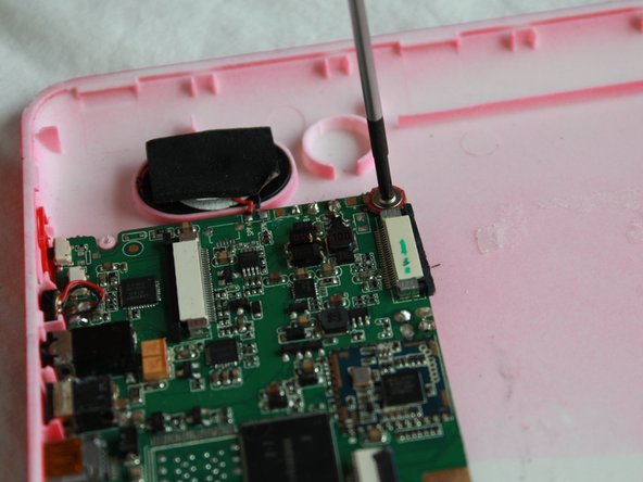

  18. HKC P776A Motherboard Replacement, Motherboard: crwdns2935265:018crwdnd2935265:01crwdnd2935265:03crwdne2935265:0 HKC P776A Motherboard Replacement, Motherboard: crwdns2935265:018crwdnd2935265:02crwdnd2935265:03crwdne2935265:0 HKC P776A Motherboard Replacement, Motherboard: crwdns2935265:018crwdnd2935265:03crwdnd2935265:03crwdne2935265:0
    • Using the screwdriver, remove the four 4mm by 1.5mm screws that are attaching the motherboard to the case.

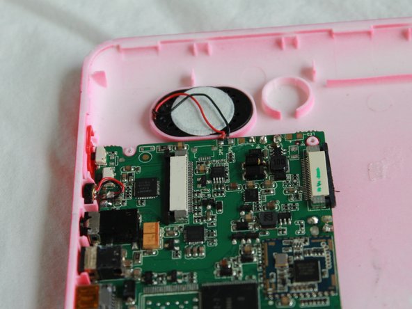

  19. HKC P776A Motherboard Replacement: crwdns2935265:019crwdnd2935265:01crwdnd2935265:02crwdne2935265:0 HKC P776A Motherboard Replacement: crwdns2935265:019crwdnd2935265:02crwdnd2935265:02crwdne2935265:0
    • Remove the black material that is covering the speaker.

  22. HKC P776A Motherboard Replacement: crwdns2935265:022crwdnd2935265:01crwdnd2935265:01crwdne2935265:0
    • Remove the motherboard from the case.
