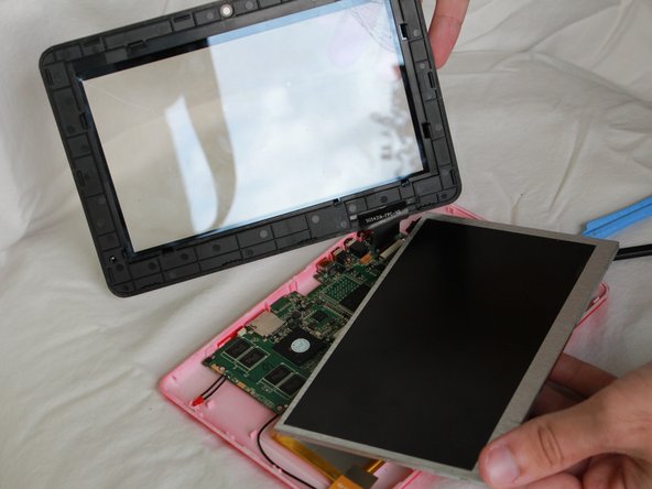

  3. HKC P776A Digitizer Replacement, Separating the Screen and the Digitizer: crwdns2935265:03crwdnd2935265:01crwdnd2935265:02crwdne2935265:0 HKC P776A Digitizer Replacement, Separating the Screen and the Digitizer: crwdns2935265:03crwdnd2935265:02crwdnd2935265:02crwdne2935265:0
    • Use your fingers to pop the screen out from the digitizer.

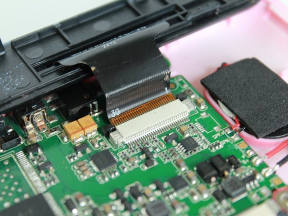

  4. HKC P776A Digitizer Replacement, Removing the Cable from the Motherboard: crwdns2935265:04crwdnd2935265:01crwdnd2935265:02crwdne2935265:0 HKC P776A Digitizer Replacement, Removing the Cable from the Motherboard: crwdns2935265:04crwdnd2935265:02crwdnd2935265:02crwdne2935265:0
    • Use the tip of the spudger to release the latches on the motherboard.
  5. HKC P776A Digitizer Replacement: crwdns2935265:05crwdnd2935265:01crwdnd2935265:01crwdne2935265:0
    • Remove the cable from the motherboard.
