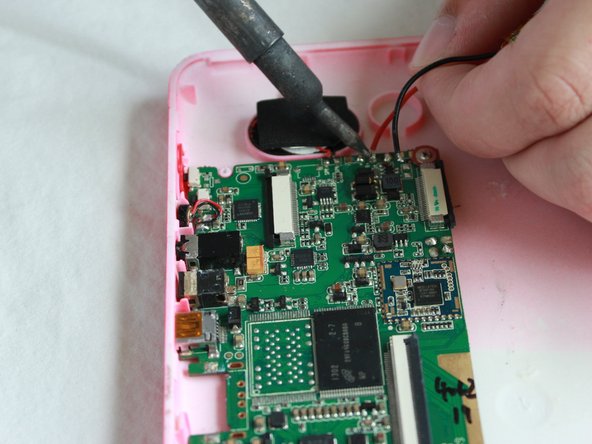

  5. HKC P776A Battery Replacement: crwdns2935265:05crwdnd2935265:01crwdnd2935265:02crwdne2935265:0 HKC P776A Battery Replacement: crwdns2935265:05crwdnd2935265:02crwdnd2935265:02crwdne2935265:0
    • Using the soldering iron, heat up the solder that is attaching the battery to the motheboard.
    • The heat from the soldering iron may cause personal injury or damage the internal components of the tablet.
  6. HKC P776A Battery Replacement: crwdns2935265:06crwdnd2935265:01crwdnd2935265:01crwdne2935265:0
    • Suck up the leftover solder using the desoldering pump.
    • Remove the battery from the motherboard.
