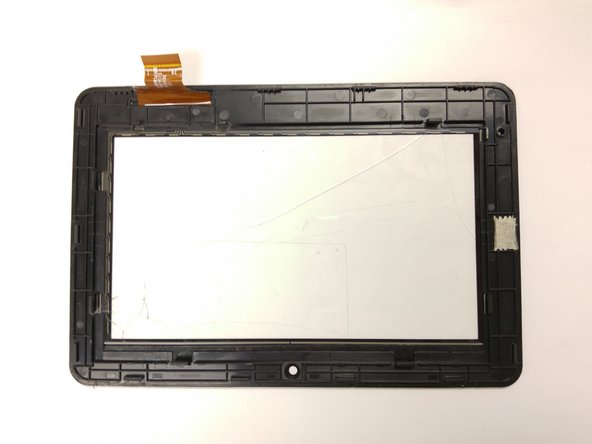

    • Insert the flat end of the spudger into the side of the device
    • This will create a gap between the device and screen housing.
    • Insert the plastic opening tool into this gap and move it along this gap.
    • Make sure not to bent the digitizer during this step.
    • The screen housing and device will now be separated.

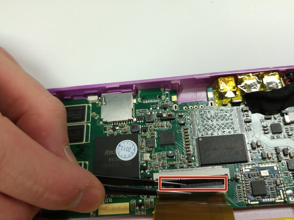

    • Once the digitizer has been been removed from the body, disconnect the digitizer band from the motherboard.
    • Two small black pins (circled in red) will need to be unlocked.
    • Unlock the pins by pulling them outward with the tweezers.
    • Make sure the pins are released entirely before attempting to remove the band.
    • Remove the band using the tweezers.

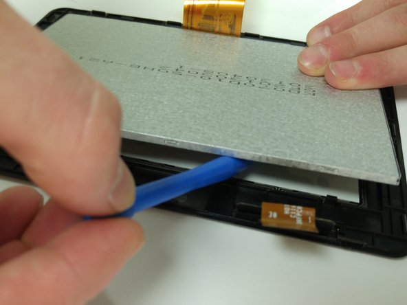

    • Once the digitizer has been disconnected from the motherboard, the LCD screen must be removed from the digitizer.
    • Push open the tabs (circled in red) using the flat end of the plastic spudger.
    • Be sure not to bend the digitizer while prying.
    • Continue to release all tabs while continuing to pry the LCD away from the digitizer.

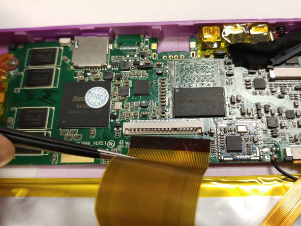

    • Once the digitizer has been removed, the LCD can be disconnected from the motherboard.
    • Use the tweezers to unlock the black pins (outlined in red) that connect the LCD band to the motherboard.
    • Once the pins have been removed, pull the band out using the tweezers.
    • Make sure not to damage the band when removing the pins.
