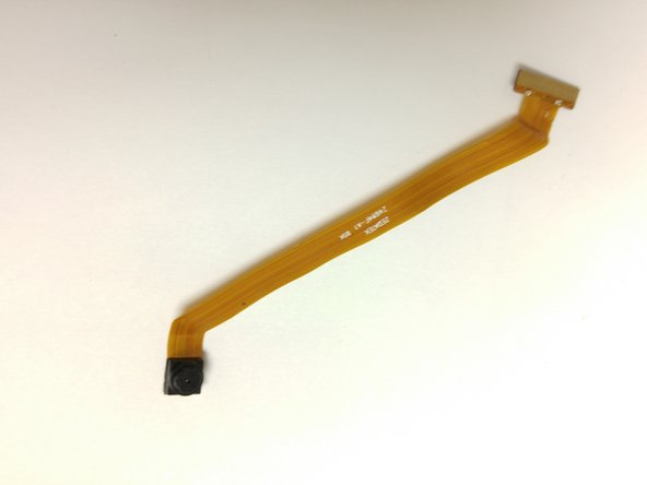

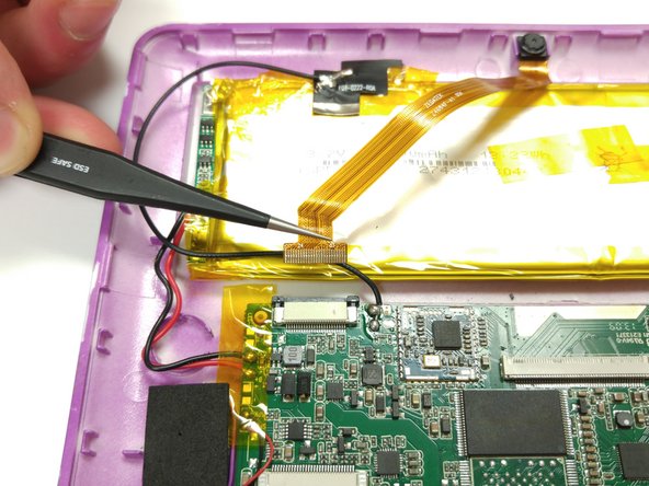

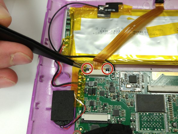

  4. HKC P774A Camera Replacement, Camera: crwdns2935265:04crwdnd2935265:01crwdnd2935265:03crwdne2935265:0 HKC P774A Camera Replacement, Camera: crwdns2935265:04crwdnd2935265:02crwdnd2935265:03crwdne2935265:0 HKC P774A Camera Replacement, Camera: crwdns2935265:04crwdnd2935265:03crwdnd2935265:03crwdne2935265:0
    • Use the tweezers to pull out the black pins (circled in red).
    • Use the tweezers to remove the camera band from the motherboard.
    • Handle the band with care.

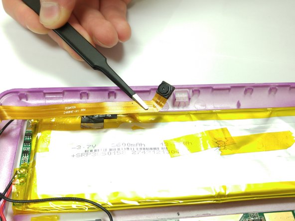

  5. HKC P774A Camera Replacement: crwdns2935265:05crwdnd2935265:01crwdnd2935265:03crwdne2935265:0 HKC P774A Camera Replacement: crwdns2935265:05crwdnd2935265:02crwdnd2935265:03crwdne2935265:0 HKC P774A Camera Replacement: crwdns2935265:05crwdnd2935265:03crwdnd2935265:03crwdne2935265:0
    • Use the flat end of the plastic spudger to pry the camera lens from the case.
    • Use the tweezers to remove the camera and band.
