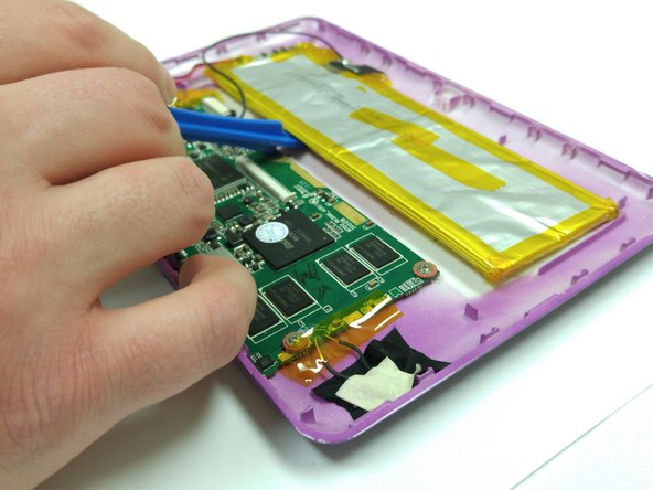

  4. HKC P774A Battery Replacement, Camera: crwdns2935265:04crwdnd2935265:01crwdnd2935265:03crwdne2935265:0 HKC P774A Battery Replacement, Camera: crwdns2935265:04crwdnd2935265:02crwdnd2935265:03crwdne2935265:0 HKC P774A Battery Replacement, Camera: crwdns2935265:04crwdnd2935265:03crwdnd2935265:03crwdne2935265:0
    • Use the tweezers to pull out the black pins (circled in red).
    • Use the tweezers to remove the camera band from the motherboard.
    • Handle the band with care.
  5. HKC P774A Battery Replacement: crwdns2935265:05crwdnd2935265:01crwdnd2935265:03crwdne2935265:0 HKC P774A Battery Replacement: crwdns2935265:05crwdnd2935265:02crwdnd2935265:03crwdne2935265:0 HKC P774A Battery Replacement: crwdns2935265:05crwdnd2935265:03crwdnd2935265:03crwdne2935265:0
    • Use the flat end of the plastic spudger to pry the camera lens from the case.
    • Use the tweezers to remove the camera and band.

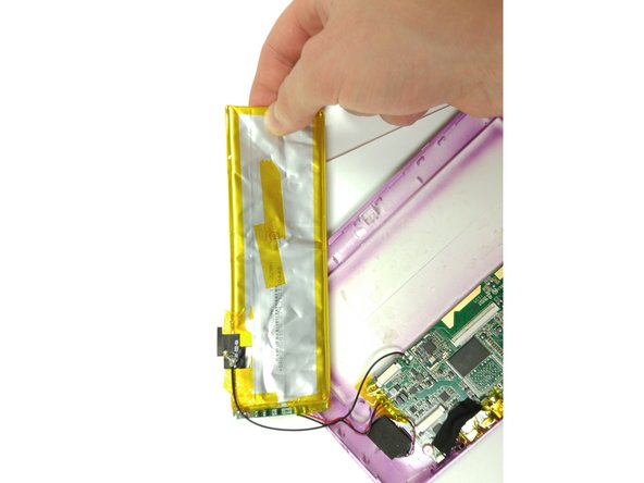

  6. HKC P774A Battery Replacement, Battery: crwdns2935265:06crwdnd2935265:01crwdnd2935265:03crwdne2935265:0 HKC P774A Battery Replacement, Battery: crwdns2935265:06crwdnd2935265:02crwdnd2935265:03crwdne2935265:0 HKC P774A Battery Replacement, Battery: crwdns2935265:06crwdnd2935265:03crwdnd2935265:03crwdne2935265:0
    • Use the plastic opening tool to begin prying the battery away from the case.
    • Be gentle as the battery is fragile.
    • Do not bend the battery. Work slowly.

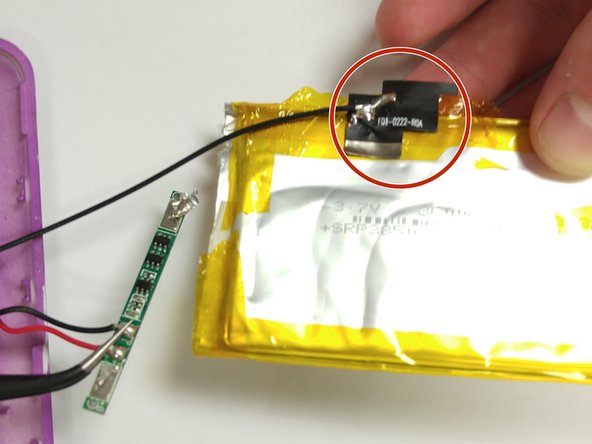

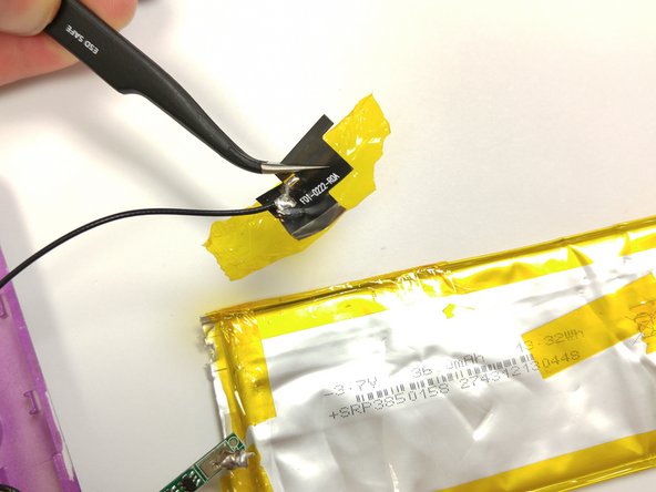

  7. HKC P774A Battery Replacement: crwdns2935265:07crwdnd2935265:01crwdnd2935265:03crwdne2935265:0 HKC P774A Battery Replacement: crwdns2935265:07crwdnd2935265:02crwdnd2935265:03crwdne2935265:0 HKC P774A Battery Replacement: crwdns2935265:07crwdnd2935265:03crwdnd2935265:03crwdne2935265:0
    • Us the tweezers to remove the circuit board from the side of the battery.
    • Be extremely gentle when removing the circuit from the battery.
    • Remove the wire by peeling off the tape.
