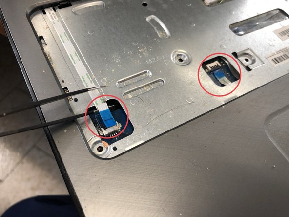

  3. HDD Replacement HP Laptop 15-g053nl: crwdns2935265:03crwdnd2935265:01crwdnd2935265:02crwdne2935265:0 HDD Replacement HP Laptop 15-g053nl: crwdns2935265:03crwdnd2935265:02crwdnd2935265:02crwdne2935265:0
    • Remove the 3 screws marked in red
    • Unhook the 2 connector and unplug the flat cables

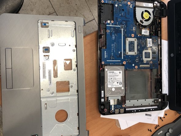

    • With a thin instrument, release the clips around the perimeter retaining the top cover, leaving the rear shell containing the motherboard etc. (The iFixit Jimmy is ideal for this.)
    • Remove the top cover, giving access to the hard disk.
