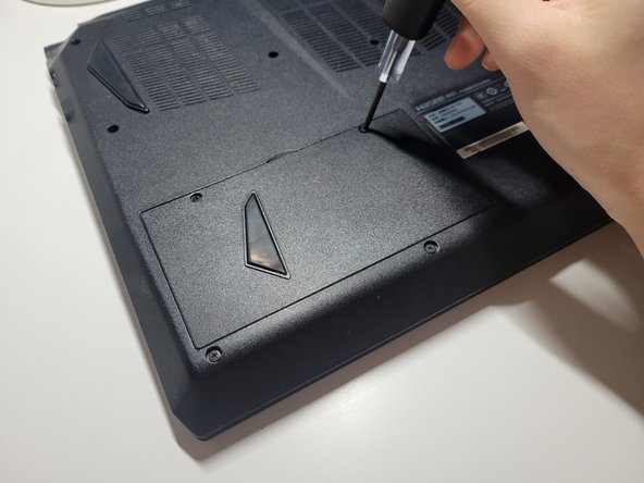

    • Flip your laptop over so the bottom is facing up and set it on a flat surface.
    • Use a Phillips #0 screwdriver to remove the two 6 mm screws that secure the battery.

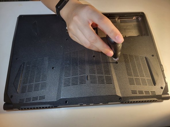

  3. HASEE Z6-SL7D1 RAM Replacement: crwdns2935265:03crwdnd2935265:01crwdnd2935265:02crwdne2935265:0 HASEE Z6-SL7D1 RAM Replacement: crwdns2935265:03crwdnd2935265:02crwdnd2935265:02crwdne2935265:0
    • Use a Phillips #0 screwdriver to remove fourteen 6 mm screws from the back panel.

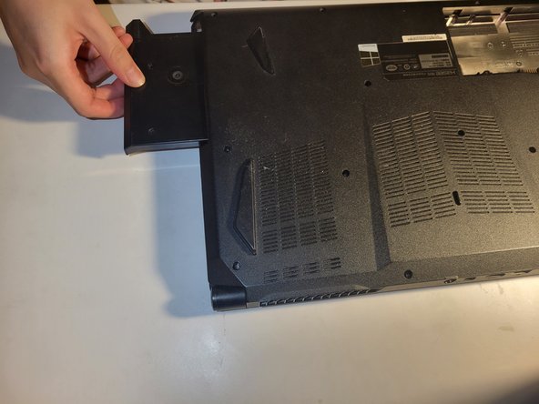

  4. HASEE Z6-SL7D1 RAM Replacement: crwdns2935265:04crwdnd2935265:01crwdnd2935265:02crwdne2935265:0 HASEE Z6-SL7D1 RAM Replacement: crwdns2935265:04crwdnd2935265:02crwdnd2935265:02crwdne2935265:0
    • If your laptop is equipped with an optical drive, carefully slide it out.
    • Alternatively, if the optical drive bay houses a hard drive tray, remove the tray by unscrewing any securing screws and gently pulling it out.

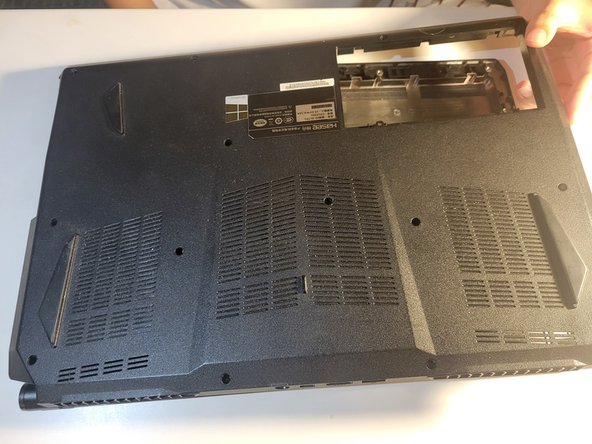

  5. HASEE Z6-SL7D1 RAM Replacement: crwdns2935265:05crwdnd2935265:01crwdnd2935265:02crwdne2935265:0 HASEE Z6-SL7D1 RAM Replacement: crwdns2935265:05crwdnd2935265:02crwdnd2935265:02crwdne2935265:0
    • Carefully slide a plastic spudger or opening tool along the edges of the back panel.
    • Gradually lift the panel away from the laptop chassis, ensuring not to force it and risking damage to internal components.

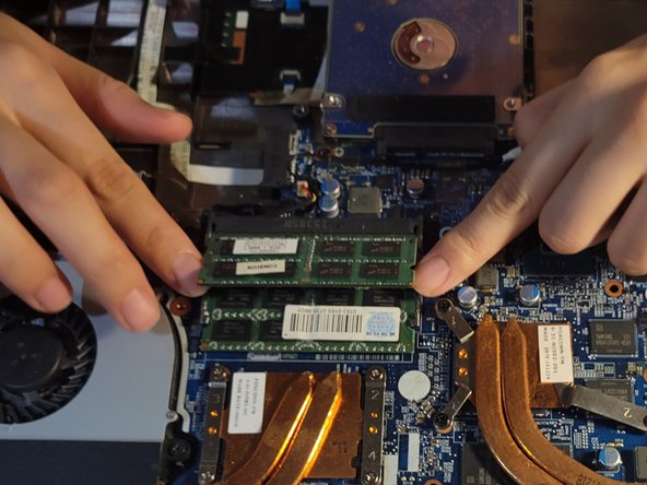

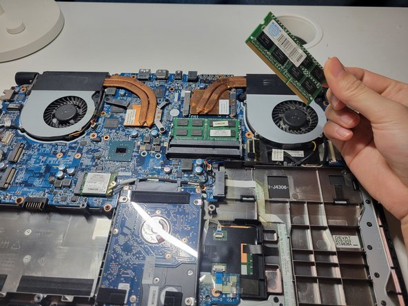

  6. HASEE Z6-SL7D1 RAM Replacement: crwdns2935265:06crwdnd2935265:01crwdnd2935265:03crwdne2935265:0 HASEE Z6-SL7D1 RAM Replacement: crwdns2935265:06crwdnd2935265:02crwdnd2935265:03crwdne2935265:0 HASEE Z6-SL7D1 RAM Replacement: crwdns2935265:06crwdnd2935265:03crwdnd2935265:03crwdne2935265:0
    • Use your fingers or a spudger to gently press the clips on the sides of the SO-DIMM slots outward to release the memory modules.
    • The RAM sticks will pop out at about a 45-degree angle.
    • Once the RAM sticks disengage, carefully slide them out of the slot at the same angle.

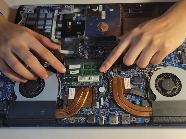

  7. HASEE Z6-SL7D1 RAM Replacement: crwdns2935265:07crwdnd2935265:01crwdnd2935265:02crwdne2935265:0 HASEE Z6-SL7D1 RAM Replacement: crwdns2935265:07crwdnd2935265:02crwdnd2935265:02crwdne2935265:0
    • When installing new memory sticks, align them with the SO-DIMM slots at the same angle and gently press them downward.
    • You will hear a click, indicating that it is securely in place.
