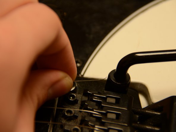

    4. Guitar String Replacement: crwdns2935265:04crwdnd2935265:01crwdnd2935265:03crwdne2935265:0 Guitar String Replacement: crwdns2935265:04crwdnd2935265:02crwdnd2935265:03crwdne2935265:0 Guitar String Replacement: crwdns2935265:04crwdnd2935265:03crwdnd2935265:03crwdne2935265:0
      • Using your allen wrench, loosen the string clamp at the bridge and remove the string.
      • You can use a "whammy bar", that should be included with the guitar, to lift up the bridge if need be.

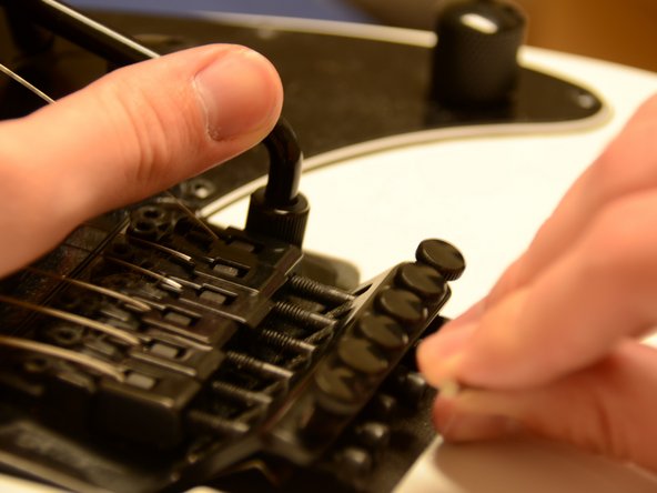

    6. Guitar String Replacement: crwdns2935265:06crwdnd2935265:01crwdnd2935265:02crwdne2935265:0 Guitar String Replacement: crwdns2935265:06crwdnd2935265:02crwdnd2935265:02crwdne2935265:0
      • Tighten the string clamp at the bridge of the guitar.
      • Remember that you can use your whammy bar to lift up the bridge if you need to.
