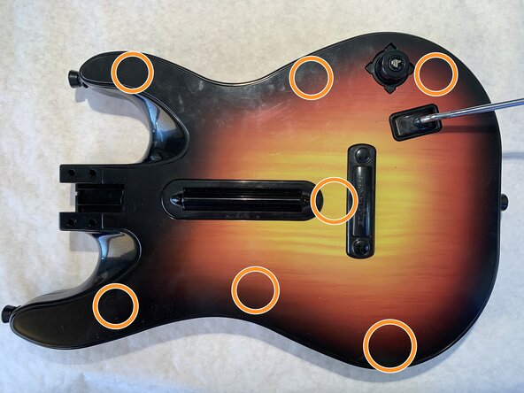

  3. Guitar Hero World Tour Guitar Strummer Replacement: crwdns2935265:03crwdnd2935265:01crwdnd2935265:03crwdne2935265:0 Guitar Hero World Tour Guitar Strummer Replacement: crwdns2935265:03crwdnd2935265:02crwdnd2935265:03crwdne2935265:0 Guitar Hero World Tour Guitar Strummer Replacement: crwdns2935265:03crwdnd2935265:03crwdnd2935265:03crwdne2935265:0
    • Ensure the face-plate lock is in the "Unlocked" position.
    • Pry the face plate off of the body by gently prying with an opening tool near the marked locations. The face plate should not be difficult to remove.
    • You can pry the face plate away with your fingers, or with any plastic/wooden tool.
    • Avoid using metal tools to pry the plastic face plate away, as it can lead to marring the plastic and ruining the finish.

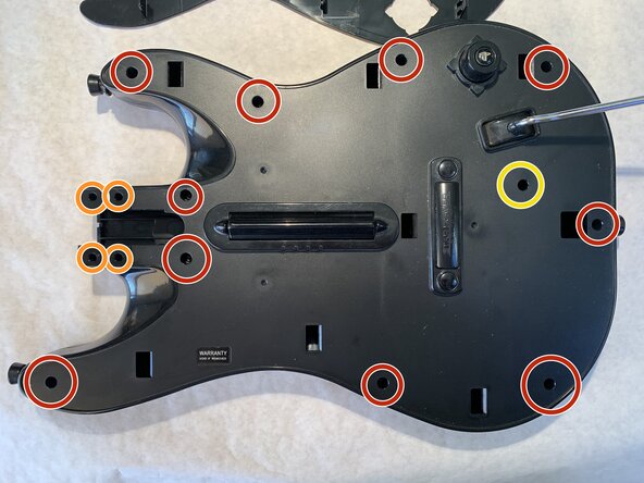

    • Remove the eleven Torx T10 screws.
    • Remove the four Phillips #0 screws. T6 screws on the Xbox controller.
    • Not included on the Xbox 360 controller.
    • There is an additional Torx T10 screw located behind the "Warranty Void" sticker.
    • Separate the two halves of the guitar body.
