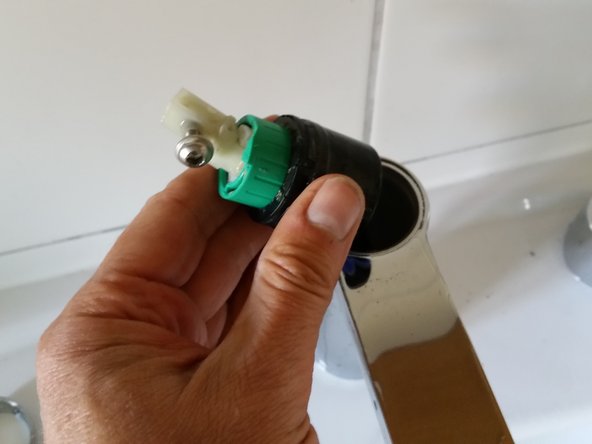

Grohe Einhebelmischer Mischpatrone Replacement
  1. Grohe Einhebelmischer Mischpatrone  Replacement, Mischpatrone Cartridge: crwdns2935265:01crwdnd2935265:01crwdnd2935265:01crwdne2935265:0
    • Push little rubber block into the head, then insert hex key. Loosen screw
  2. Grohe Einhebelmischer Mischpatrone  Replacement: crwdns2935265:02crwdnd2935265:01crwdnd2935265:01crwdne2935265:0
    • The cover is not easy to remove. Some vinegar, tapping and a bit of patience will help. Pull it out while turning it slightly
  3. Grohe Einhebelmischer Mischpatrone  Replacement: crwdns2935265:03crwdnd2935265:01crwdnd2935265:02crwdne2935265:0 Grohe Einhebelmischer Mischpatrone  Replacement: crwdns2935265:03crwdnd2935265:02crwdnd2935265:02crwdne2935265:0
    • Open screw-ring ant pull cartridge out
