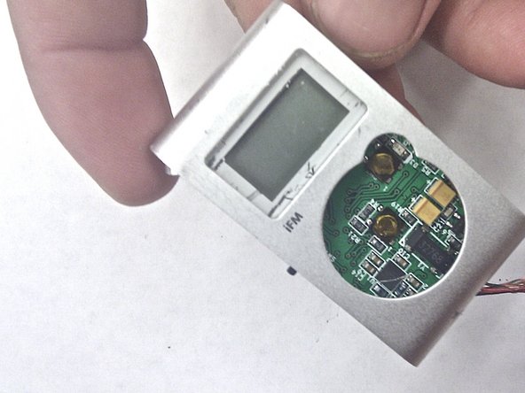

    • Notice in the attached image that the backside of the button has an elevated corner. This corner must be applying pressure on the golden plate seen in the picture to the right. The center pressure point of the button must also apply pressure to the golden plate in the middle. These plates are both circled in red in the picture to the left.

  7. Griffin iFM 4027 LCD Screen Cover Replacement, Media Player Accessory: crwdns2935265:07crwdnd2935265:01crwdnd2935265:02crwdne2935265:0 Griffin iFM 4027 LCD Screen Cover Replacement, Media Player Accessory: crwdns2935265:07crwdnd2935265:02crwdnd2935265:02crwdne2935265:0
    • Carefully remove the circuit board and attached LCD component from the device by pulling it towards the open left side.
  8. Griffin iFM 4027 LCD Screen Cover Replacement: crwdns2935265:08crwdnd2935265:01crwdnd2935265:01crwdne2935265:0
    • Carefully lift the rectangular screen cover off the LCD screen.
  9. Griffin iFM 4027 LCD Screen Cover Replacement, LCD Screen Cover: crwdns2935265:09crwdnd2935265:01crwdnd2935265:02crwdne2935265:0 Griffin iFM 4027 LCD Screen Cover Replacement, LCD Screen Cover: crwdns2935265:09crwdnd2935265:02crwdnd2935265:02crwdne2935265:0
    • Place the screen cover on top of the LCD so it covers its entirety. Carefully slide the circuit board/LCD back into the device.
