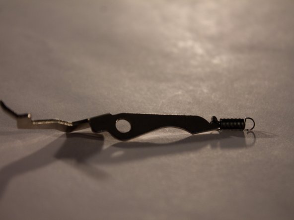

Greist Buttonholer Fork Arm Spring Replacement
  1. Greist Buttonholer Fork Arm Spring Replacement, Unscrew the Lower Hook Holding the Spring: crwdns2935265:01crwdnd2935265:01crwdnd2935265:03crwdne2935265:0 Greist Buttonholer Fork Arm Spring Replacement, Unscrew the Lower Hook Holding the Spring: crwdns2935265:01crwdnd2935265:02crwdnd2935265:03crwdne2935265:0 Greist Buttonholer Fork Arm Spring Replacement, Unscrew the Lower Hook Holding the Spring: crwdns2935265:01crwdnd2935265:03crwdnd2935265:03crwdne2935265:0
    • Unscrew the screw located underneath fork arm using a Flathead screwdriver.
  2. Greist Buttonholer Fork Arm Spring Replacement, Remove the Lower Hook: crwdns2935265:02crwdnd2935265:01crwdnd2935265:03crwdne2935265:0 Greist Buttonholer Fork Arm Spring Replacement, Remove the Lower Hook: crwdns2935265:02crwdnd2935265:02crwdnd2935265:03crwdne2935265:0 Greist Buttonholer Fork Arm Spring Replacement, Remove the Lower Hook: crwdns2935265:02crwdnd2935265:03crwdnd2935265:03crwdne2935265:0
    • Raise the fork arm so that it is parallel with the upper hook.
    • Turn the lower hook towards you from the bottom, and remove.
  3. Greist Buttonholer Fork Arm Spring Replacement, Replace the Spring: crwdns2935265:03crwdnd2935265:01crwdnd2935265:02crwdne2935265:0 Greist Buttonholer Fork Arm Spring Replacement, Replace the Spring: crwdns2935265:03crwdnd2935265:02crwdnd2935265:02crwdne2935265:0
    • Remove the old spring from the hook.
    • Add the new spring to the hook.
