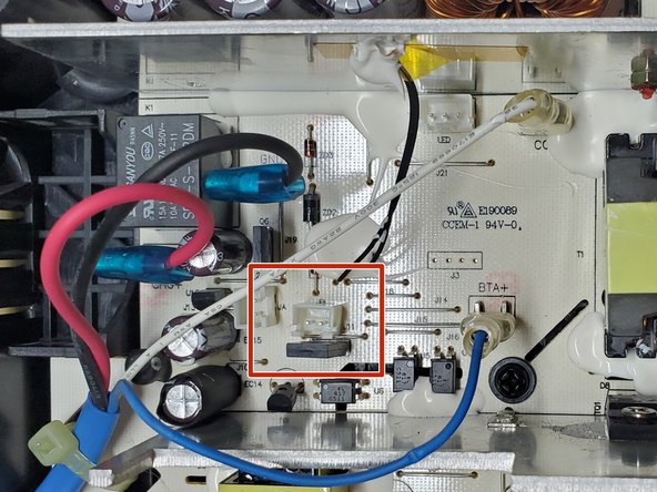

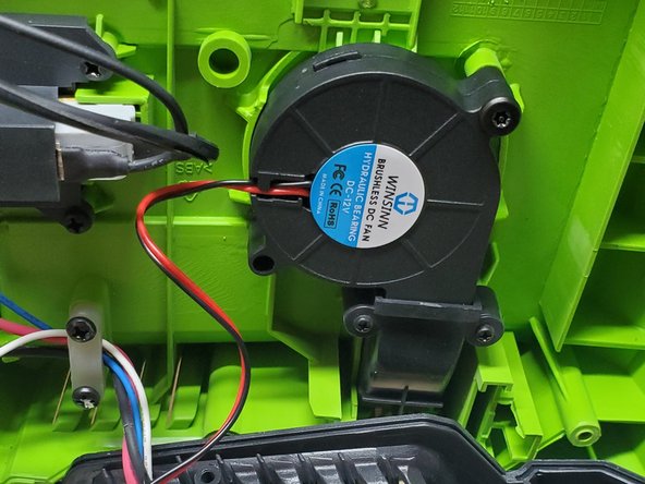

  3. Greenworks Pro 80V Battery Charger Cooling Fan Replacement, Remove and replace the blower fan: crwdns2935265:03crwdnd2935265:01crwdnd2935265:03crwdne2935265:0 Greenworks Pro 80V Battery Charger Cooling Fan Replacement, Remove and replace the blower fan: crwdns2935265:03crwdnd2935265:02crwdnd2935265:03crwdne2935265:0 Greenworks Pro 80V Battery Charger Cooling Fan Replacement, Remove and replace the blower fan: crwdns2935265:03crwdnd2935265:03crwdnd2935265:03crwdne2935265:0
    • Remove the single T15H screw holding the fan
    • To remove the fan, pivot it counterclockwise to disconnect it from the housing and then lift it off the pin on the bottom left
    • The blower fan is connected to the right 2-pin connector labeled JB

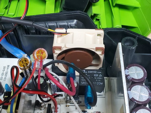

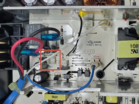

  4. Greenworks Pro 80V Battery Charger Cooling Fan Replacement, Remove and replace the case fan: crwdns2935265:04crwdnd2935265:01crwdnd2935265:03crwdne2935265:0 Greenworks Pro 80V Battery Charger Cooling Fan Replacement, Remove and replace the case fan: crwdns2935265:04crwdnd2935265:02crwdnd2935265:03crwdne2935265:0 Greenworks Pro 80V Battery Charger Cooling Fan Replacement, Remove and replace the case fan: crwdns2935265:04crwdnd2935265:03crwdnd2935265:03crwdne2935265:0
    • The case fan does not have any screws holding it in place
    • The case fan connects to the left 2-pin power connector labelled JA
