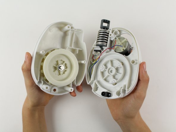

  2. GravityLight Mounting Post Replacement and Spring Replacement, Opening the Device Housing: crwdns2935265:02crwdnd2935265:01crwdnd2935265:01crwdne2935265:0
    • Some of the internal pieces may loosen or fall out during disassembly.
    • Firmly grasp both parts of the GravityLight body and pull them apart.

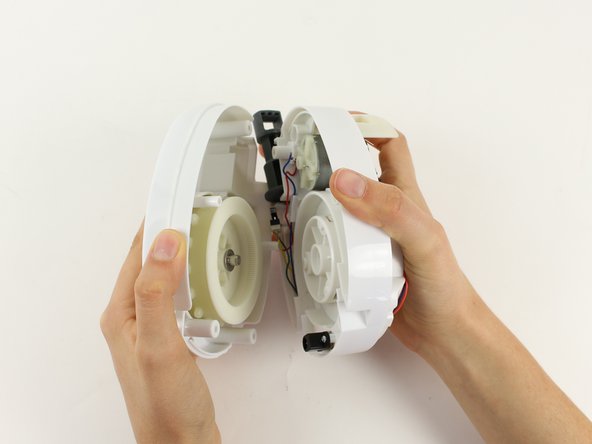

  3. GravityLight Mounting Post Replacement and Spring Replacement, Removing the Back Panel Screws: crwdns2935265:03crwdnd2935265:01crwdnd2935265:01crwdne2935265:0
    • Place the back panel, the larger of the two pieces, on a sturdy surface with its back down.
    • Unscrew the two 2cm Phillips 00 screws on the inside of the back panel.
  4. GravityLight Mounting Post Replacement and Spring Replacement, Separating the Back Panel Housing: crwdns2935265:04crwdnd2935265:01crwdnd2935265:03crwdne2935265:0 GravityLight Mounting Post Replacement and Spring Replacement, Separating the Back Panel Housing: crwdns2935265:04crwdnd2935265:02crwdnd2935265:03crwdne2935265:0 GravityLight Mounting Post Replacement and Spring Replacement, Separating the Back Panel Housing: crwdns2935265:04crwdnd2935265:03crwdnd2935265:03crwdne2935265:0
    • Firmly grasp both parts of the back panel and pull them apart.
