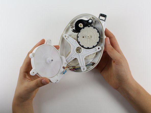

  2. GravityLight LED Replacement, Opening the Device Housing: crwdns2935265:02crwdnd2935265:01crwdnd2935265:01crwdne2935265:0
    • Some of the internal pieces may loosen or fall out during disassembly.
    • Firmly grasp both parts of the GravityLight body and pull them apart.
