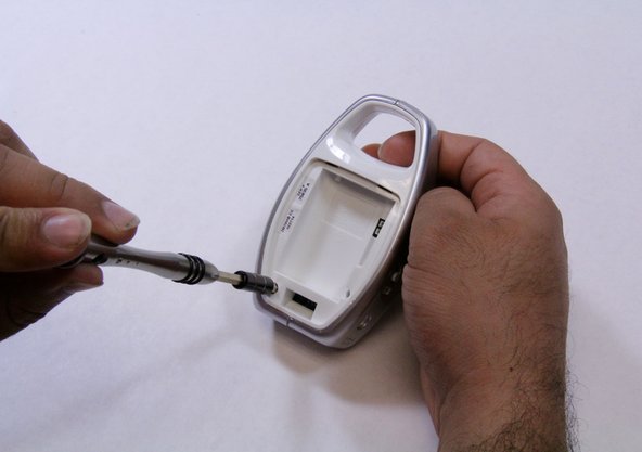

    • Using plastic opening tool, pry and remove the battery lid.
  2. Graco Secure Coverage LED Parent Unit Replacement: crwdns2935265:02crwdnd2935265:01crwdnd2935265:01crwdne2935265:0
    • Remove the battery by holding the device with one hand and pulling the battery out with other hand carefully.
    • Make sure that you disconnect the battery's wire before you remove the battery.
  3. Graco Secure Coverage LED Parent Unit Replacement, LED Parent Unit: crwdns2935265:03crwdnd2935265:01crwdnd2935265:02crwdne2935265:0 Graco Secure Coverage LED Parent Unit Replacement, LED Parent Unit: crwdns2935265:03crwdnd2935265:02crwdnd2935265:02crwdne2935265:0
    • There are two screws on the rare case of the device. For the one shown in blue marker requires either an extended screwdriver or putting on a little pressure on a regular screwdriver.
    • Remove the two 9mm Phillips #1 screws from the rare case of the device.
    • If you cannot remove the screw with low pressure, do not use high pressure to remove it. It may cause a damage on the device case. Use an extended screwdriver instead.

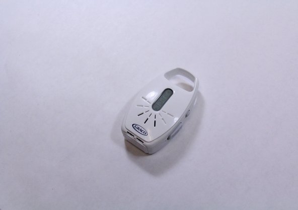

  4. Graco Secure Coverage LED Parent Unit Replacement: crwdns2935265:04crwdnd2935265:01crwdnd2935265:02crwdne2935265:0 Graco Secure Coverage LED Parent Unit Replacement: crwdns2935265:04crwdnd2935265:02crwdnd2935265:02crwdne2935265:0
    • Using opening plastic tool, pry the two grey cases from both sides of the device.
    • Take your time and apply constant force to avoid breaking or damaging any other plastic parts.
    • While pry off the grey cases, hold the device with your other hand to remove the cases

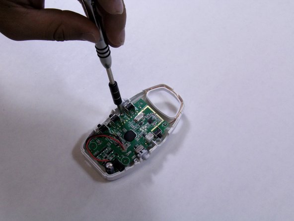

  6. Graco Secure Coverage LED Parent Unit Replacement: crwdns2935265:06crwdnd2935265:01crwdnd2935265:02crwdne2935265:0 Graco Secure Coverage LED Parent Unit Replacement: crwdns2935265:06crwdnd2935265:02crwdnd2935265:02crwdne2935265:0
    • Remove the 7mm Phillips #1 screw from the mother board.
    • Place the screw in a secure place.

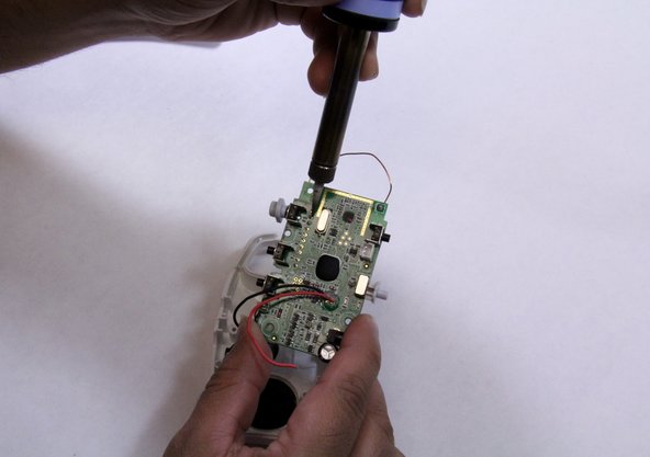

  7. Graco Secure Coverage LED Parent Unit Replacement: crwdns2935265:07crwdnd2935265:01crwdnd2935265:02crwdne2935265:0 Graco Secure Coverage LED Parent Unit Replacement: crwdns2935265:07crwdnd2935265:02crwdnd2935265:02crwdne2935265:0
    • Flip over the motherboard.
    • Solder off LED from motherboard.
    • There are many pins attached to the motherboard, make sure you solder off the proper pins that attached to the LED's.
    • Replace the LED's
