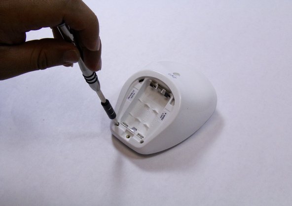

    • Remove the 9mm screw from the battery cover of the nursery unit using a Phillips #1 tip screwdriver.
  2. Graco Secure Coverage LED Nursery Unit Replacement: crwdns2935265:02crwdnd2935265:01crwdnd2935265:02crwdne2935265:0 Graco Secure Coverage LED Nursery Unit Replacement: crwdns2935265:02crwdnd2935265:02crwdnd2935265:02crwdne2935265:0
    • Using the plastic opening tool, pry and remove the battery cover carefully.
    • Remove the batteries using plastic opening tool.
    • Replace the batteries.
  3. Graco Secure Coverage LED Nursery Unit Replacement, LED Nursery Unit: crwdns2935265:03crwdnd2935265:01crwdnd2935265:02crwdne2935265:0 Graco Secure Coverage LED Nursery Unit Replacement, LED Nursery Unit: crwdns2935265:03crwdnd2935265:02crwdnd2935265:02crwdne2935265:0
    • Remove the two 9mm Phillips #1 screws from the rare case of the device.
    • Place the screws in a secure place.

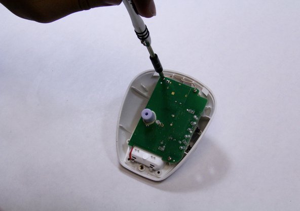

  5. Graco Secure Coverage LED Nursery Unit Replacement: crwdns2935265:05crwdnd2935265:01crwdnd2935265:02crwdne2935265:0 Graco Secure Coverage LED Nursery Unit Replacement: crwdns2935265:05crwdnd2935265:02crwdnd2935265:02crwdne2935265:0
    • Remove all three 7mm Phillips #1 screws from the mother board.
    • Place the screws in secure place.

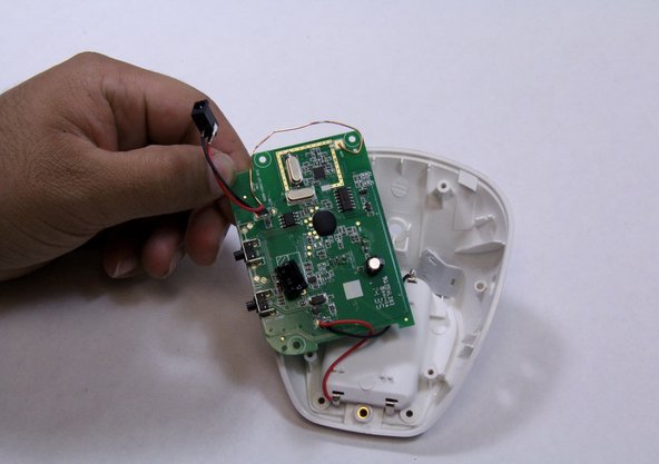

    • Flip over the motherboard to look at the LED pins that are connected to it.
    • Solder off the LED pin from the motherboard.
    • There are many pins are connect to the motherboard, so make sure that you solder off the LED pin.
    • Replace the LED.
