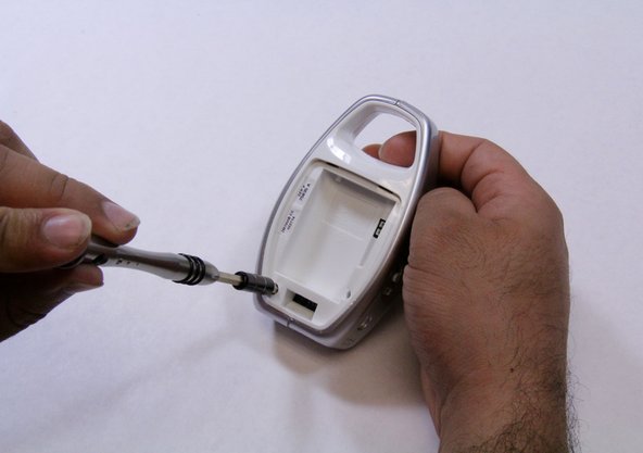

  3. Graco Secure Coverage  Speaker Replacement on Parent Unit, Parent Unit Speaker: crwdns2935265:03crwdnd2935265:01crwdnd2935265:02crwdne2935265:0 Graco Secure Coverage  Speaker Replacement on Parent Unit, Parent Unit Speaker: crwdns2935265:03crwdnd2935265:02crwdnd2935265:02crwdne2935265:0
    • There are two screws on the rare case of the device. For the one shown in red marker requires either an extended screwdriver or putting on a little pressure on a regular screwdriver.
    • Remove the two 9mm Phillips #1 screws from the rare case of the device.
    • If you cannot remove the screw with low pressure, do not use high pressure to remove it. It may cause a damage on the device case. Use an extended screwdriver instead.

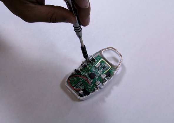

  6. Graco Secure Coverage  Speaker Replacement on Parent Unit: crwdns2935265:06crwdnd2935265:01crwdnd2935265:02crwdne2935265:0 Graco Secure Coverage  Speaker Replacement on Parent Unit: crwdns2935265:06crwdnd2935265:02crwdnd2935265:02crwdne2935265:0
    • Remove the 7mm Phillips #1 screw from the mother board.
    • Place the screw in a secure place.
    • Pull out the mother board away from the case carefully.

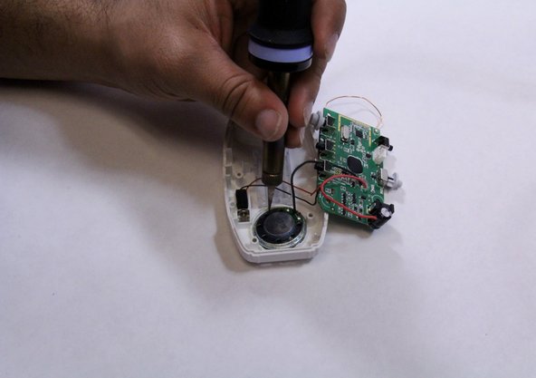

  7. Graco Secure Coverage  Speaker Replacement on Parent Unit: crwdns2935265:07crwdnd2935265:01crwdnd2935265:02crwdne2935265:0 Graco Secure Coverage  Speaker Replacement on Parent Unit: crwdns2935265:07crwdnd2935265:02crwdnd2935265:02crwdne2935265:0
    • Pick up the motherboard.
    • Solder off the speaker from the device's case.
    • Solder off the speaker from the mother board.
    • There are many pins attached to the mother board, make sure you solder off the proper pins that attached to the speaker wires.
    • Replace the speaker.
