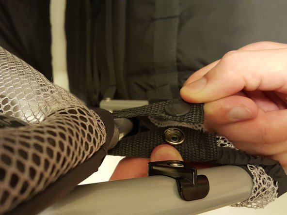

    • Locate the two buttons holding the fabric basket frame on either side of the stroller.
    • Unbutton the two buttons.

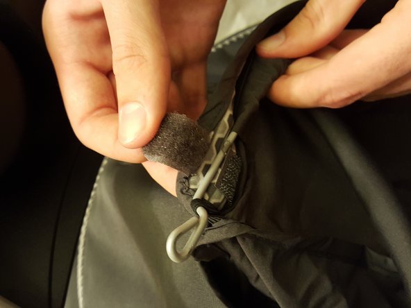

    • Locate the three velcro straps holding the seat to the canopy.
    • Undo the three straps.
